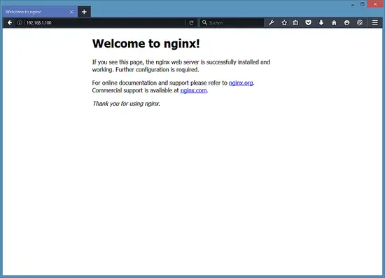

Type in your web server’s IP address or hostname into a browser (e.g. http://192.168.1.100), and you should see the Nginx welcome page:

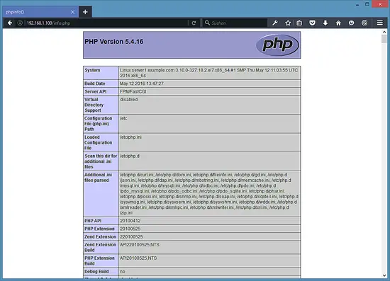

Now create the following PHP file in the document root /usr/share/nginx/html
nano /usr/share/nginx/html/info.php
<?php
phpinfo();
Now we call that file in a browser (e.g. http://192.168.1.100/info.php):
As you see, PHP 5 is working, and it’s working through FPM/FastCGI, as shown in the Server API line. If you scroll further down, you will see all modules that are already enabled in PHP5, including the MySQL module:
