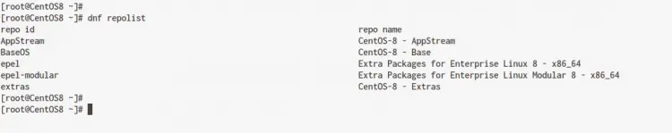

After that, check all available repositories using the following command.
dnf repolist
Now make sure that you get the EPEL repository on the result.

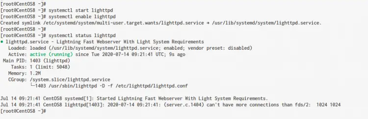

Once all installation is completed, start the Lighttpd service and add it to the system boot.
systemctl start lighttpd
systemctl enable lighttpd
Now check the Lighttpd service status using the following command.
systemctl status lighttpd
Below is the result you will get.
As a result, the Lighttpd service is up and running on the CentOS 8 system.

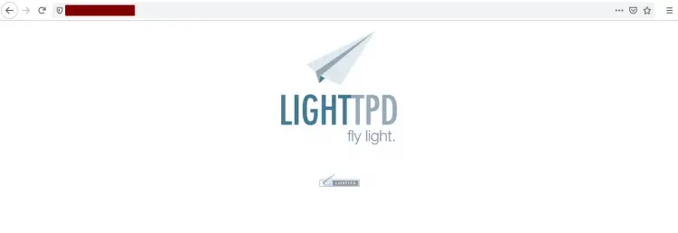

Now open your web browser and type the server IP address on the address bar.
http://192.168.1.50/
As a result, you will get the default ‘index.html’ of the Lighttpd web server.

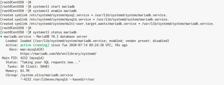

Once all installation is finished, start the MariaDB service and add it to the system boot.
systemctl start mariadb
systemctl enable mariadb
Now check the MariaDB service using the command below.
systemctl status mariadb
As a result, the MariaDB service is up and running on the CentOS 8 system.

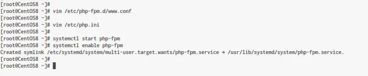

Next, start the PHP-FPM service and add it to the system boot.
systemctl start php-fpm
systemctl enable php-fpm

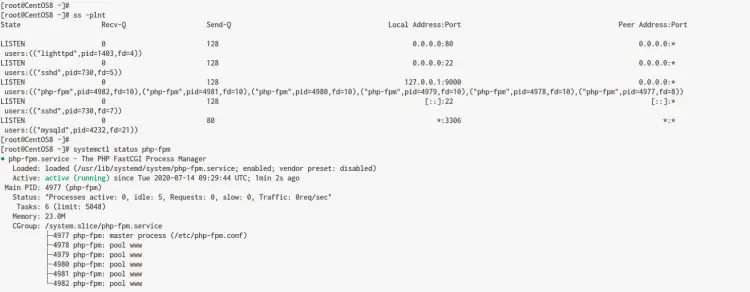

The PHP-FPM service is up and running, check using the following command.
ss -plnt
systemctl status php-fpm
As a result, the PHP-FPM is up and running on the CentOS 8 server with the local IP address and port ‘9000’.

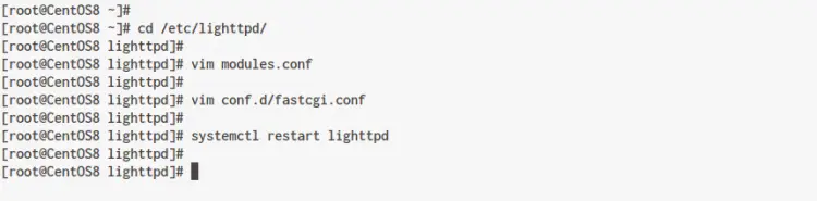

– Enable FastCGI Module
Before going any further, go to the ‘/etc/lighttpd/’ directory and edit the configuration ‘modules.conf’ using vim editor.
cd /etc/lighttpd/
vim modules.conf
Uncomment the ‘FastCGI’ module as below.
## FastCGI (mod_fastcgi)
include "conf.d/fastcgi.conf"
Save and close.
Next, we must add our PHP configuration to the ‘conf.d/fastcgi.conf’ configuration file.
Inside the ‘/etc/lighttpd’ directory, edit the FastCGI configuration ‘conf.d/fastcgi.conf’ using vim editor.
vim conf.d/fastcgi.conf

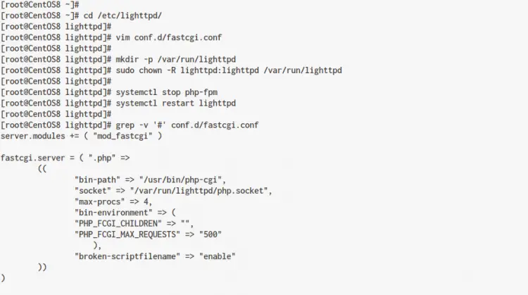

– Using Self Spawning PHP Service
Next, if you want to use the self spawning PHP-CGI for Lighttpd, paste the following configuration into it.
fastcgi.server = ( ".php" =>
                "bin-path" => "/usr/bin/php-cgi",
                "socket" => "/var/run/lighttpd/php.socket",
                "max-procs" => 4,
                "bin-environment" => (
                "PHP_FCGI_CHILDREN" => "",
                "PHP_FCGI_MAX_REQUESTS" => "500"
                "broken-scriptfilename" => "enable"
Save and close.
Next, create a new directory ‘/var/run/lighttpd’ and change the ownership of that directory to the ‘lighttpd’ user.
mkdir -p /var/run/lighttpd
sudo chown -R lighttpd:lighttpd /var/run/lighttpd
Now restart the Lighttpd service to apply the new configuration.
systemctl restart lighttpd
Ensure there is no error, and as a result, the configuration of Lighttpd with PHP-FPM Service or using spawning PHP-CGI has been completed successfully.

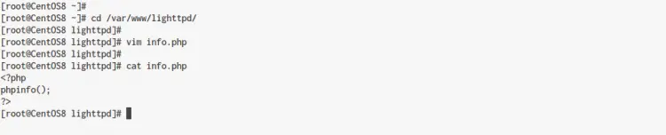

To test our LLMP installation, we will create a new phpinfo file on the default Lighttpd Document Root directory.
Go to the ‘/var/www/lighttpd’ directory and create a new php file ‘info.php’ using vim editor.
cd /var/www/lighttpd/
vim info.php
Paste the following script into it.
<?php
phpinfo();
Save and close.

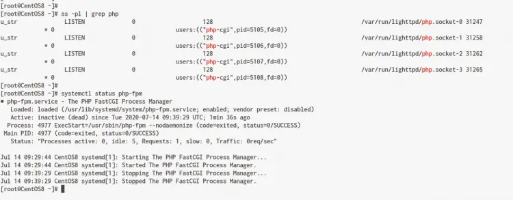

Step 6 – Additional: Checking PHP and Lighttpd Services
If you’re running the Lighttpd with slef-spawned PHP service using the ocnfiguration below.
You can check the PHP service using the command below.
ss -pl | grep php
As can be seen, the self-spawned PHP process is running under 4 socket file. Even the PHP-FPM service is down, the Lighttpd is still working for processing PHP applications.
