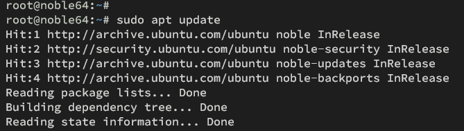

First, run the command below to update your Ubuntu package index.

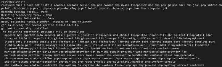

Now run the following commands to install dependencies such as LAMP Stack (Linux, Apache, MySQL/MariaDB, and PHP), Composer, and Git to your Ubuntu system.
sudo apt install apache2 mariadb-server php php-common php-mysql libapache2-mod-php php-gd php-curl php-json php-xmlrpc php-intl php-bcmath php-zip php-apcu php-mbstring php-fileinfo php-xml php-soap php-tokenizer composer git
Type Y to confirm the installation.

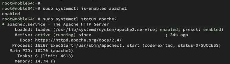

After the installation, check the Apache service status with the following command. You will see the Apache web server is enabled with the status ‘active (running)‘.
sudo systemctl is-enabled apache2
sudo systemctl status apache2

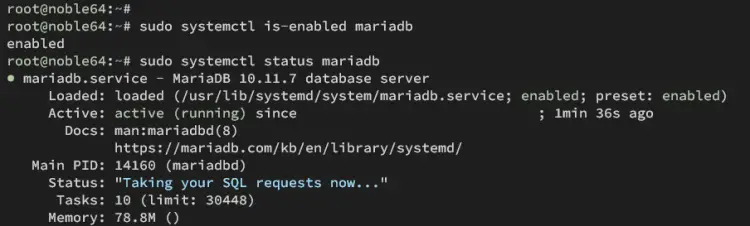

Now verify the MariaDB server with the following command. You will see a similar output, where the MariaDB is enabled and running.
sudo systemctl is-enabled mariadb
sudo systemctl status mariadb

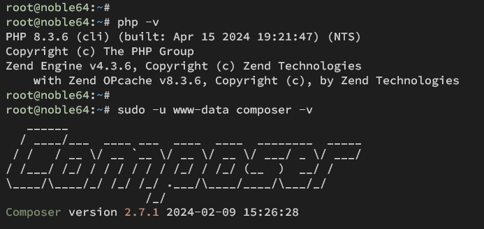

Lastly, check the PHP and Composer versions with the following command. You will see that PHP 8.3 and Composer 2.7.1 is installed on your Ubuntu system.
php -v
sudo -u www-data composer -v

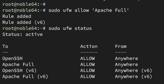

After installing dependencies, you need to allow access to the Apache web server via UFW (Uncomplicated Firewall). The Apache web server provides a UFW application profile ‘Apache Full‘ to allow both HTTP and HTTPS access.
Run the command below to open both HTTP and HTTPS access via the ‘Apache Full‘ profile. When added, you will see an output ‘Rules Added‘.
sudo ufw allow 'Apache Full'
Now verify the list rules on your UFW with the following command.
sudo ufw status
You should get the ‘Apache Full‘ profile enabled on your firewall. With this, both HTTP and HTTPS access to your Apache web server is allowed.

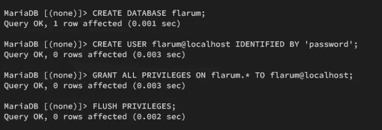

Now run the following queries to create a new database and user for Flarum. In this example, you will create a new database ‘flarum‘, a user ‘flarum‘, with the password ‘password‘. You can replace those with your information.
CREATE DATABASE flarum;
CREATE USER flarum@localhost IDENTIFIED BY 'password';
GRANT ALL PRIVILEGES ON flarum.* TO flarum@localhost;
FLUSH PRIVILEGES;

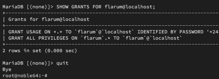

Next, run the query below to verify the privileges of user ‘flarum‘. This will ensure that user ‘flarum‘ can access the database ‘flarum‘.
SHOW GRANTS FOR flarum@localhost;
You can see below the user ‘flarum‘ can access the database ‘flarum‘.

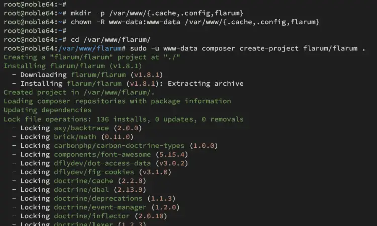

Now move to the ‘/var/www/flarum/‘ directory and download the Flarum source code via the Composer command below.
cd /var/www/flarum/
sudo -u www-data composer create-project flarum/flarum .
You can see below the downloading process of the Flarum source code.

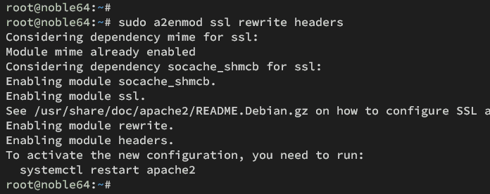

Before creating a virtual host, run the following command to enable Apache modules ‘ssl‘, ‘rewrite‘, and ‘headers‘.
sudo a2enmod ssl rewrite headers

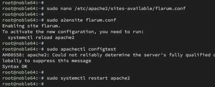

Next, run the command below to activate the virtual host file ‘flarum.conf’ and verify your Apache syntax.
sudo a2ensite flarum.conf
sudo apachectl configtest
You should have an output ‘Syntax OK‘ when you have proper Apache configuration.
Lastly, run the following command to restart the Apache web server and apply the new Flarum virtual host configuration. With this, your Flarum should be accessible.

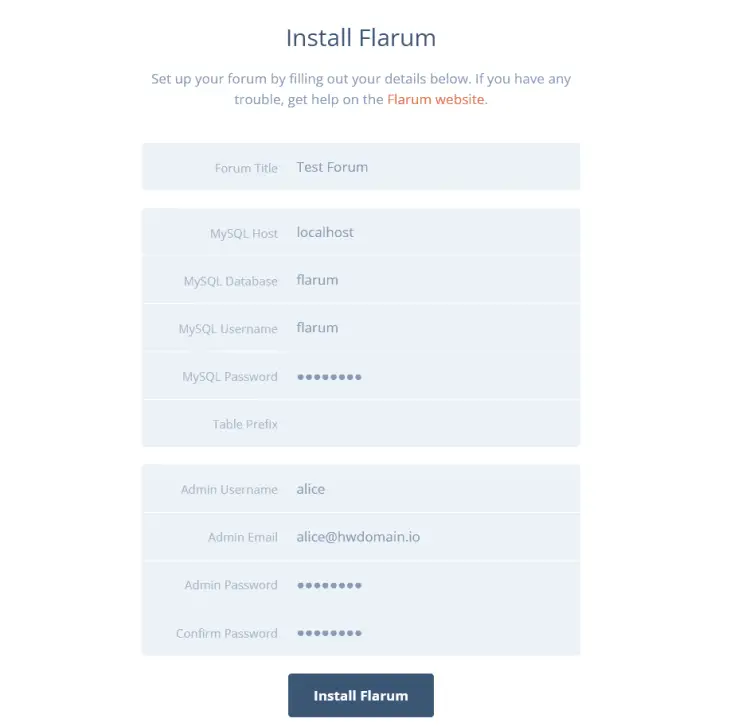

Open your web browser and visit your domain name such as https://forum.howtoforge.local/. If your configuration is successful, you should get the Flarum installation wizard.
Input your forum title, details of the MariaDB database, user, and password. Then, input details admin user, email, and password for your new Flarum installation.
Click the ‘Install Flarum‘ button to continue the installation.

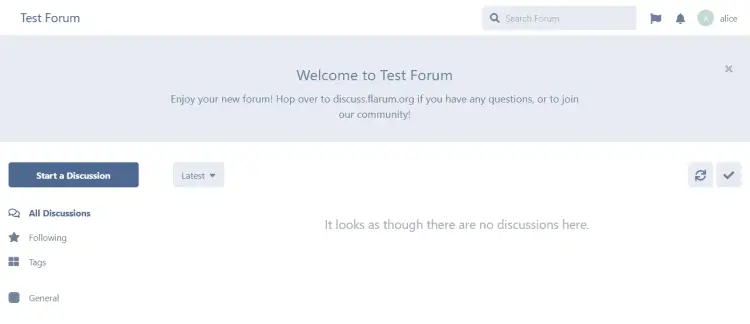

Once the installation is complete, you will be shown the Flarum administration dashboard like the following:
Now click on your user icon and select Administration. This will show you details of your Flarum installation.
