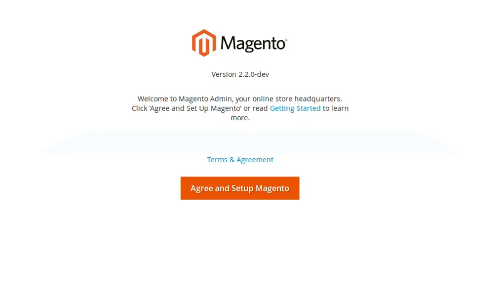

✅ Step 9: Finalize Magento Installation
Complete the Magento installation via the web setup wizard by navigating to your domain in a browser. Follow the on-screen instructions to finish the setup.
