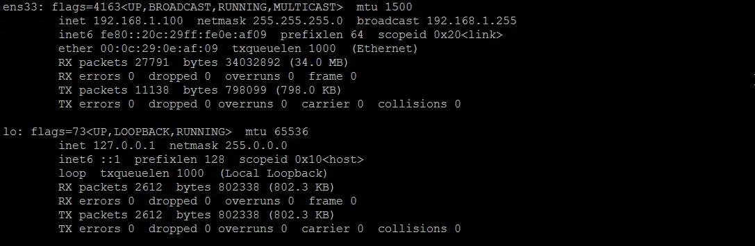

Before we start configuring vnstat, use ifconfig to get the name of the network interface that we want to monitor.
ifconfig
The result on my system is:
So my main network interface has the name ens33.

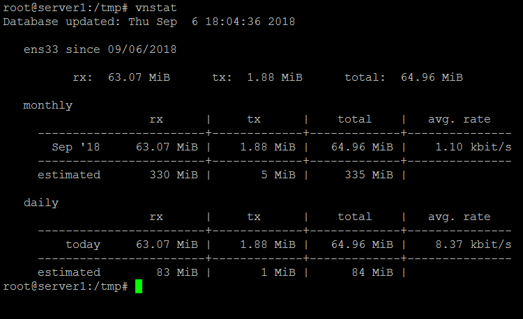

The most basic usage of vnStat is opening a terminal and executing the command:
vnstat
This gives a month wise summary of total network traffic from all the registered interfaces. I have added an image of my network traffic. You can see below that for the network interface “eth0”, it says “Not enough Data available yet”. This is because I enabled traffic monitoring for eth0 just while I was writing this post. So, if you have enabled it recently, both eth0 and wlan0 will show that there is not enough data. But soon after using the internet for a while it will change and will look similar to “wlan0” below:

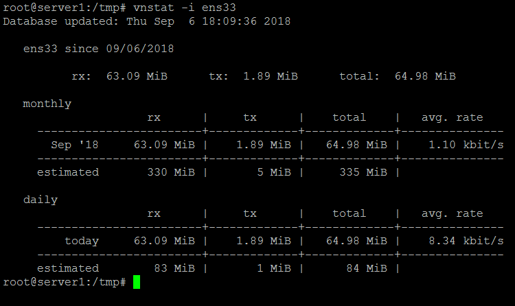

For specific but basic usage you can monitor specific network interfaces by using the “-i” option. So, the command for ens33, will be like:
vnstat -i ens33
Replacing the “ens33” from above command with any other interface like “eth0” or “wlan0” will give the statistics for that interface. An example for “ens33” is shown below. Depending on when you have started vnStat and the usage of your network it might look similar to one or both of the images below.
It can be seen that at the end on each table, vnStat provides an estimated network usage of the month. Sometimes this is very useful and helps the user to control the bandwidth usage. This is one of the many useful features of vnStat.

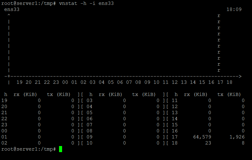

We can view hourly statistics in the form of a console-based graph followed by a table representing the usage for the last 24 hours. We can use this by using the “-h” option. Use the following command:
vnstat -h -i ens33
So, you can replace the “wlan0” with say “eth0” and you will get the result for that. The image below shows the wlan0 hourly statistics for my system.

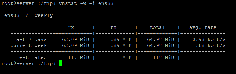

5.3 Weekly statistics
We can use the “-w” option to view the weekly statistics for an interface.
vnstat -w -i ens33

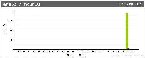

6.2 Hourly display of stats
We can use the “-h” option to get the output for hourly display. The command and output are shown below. The display is always for the last 24 hours.
vnstati -h -i ens33 -o ~/summary2.png
