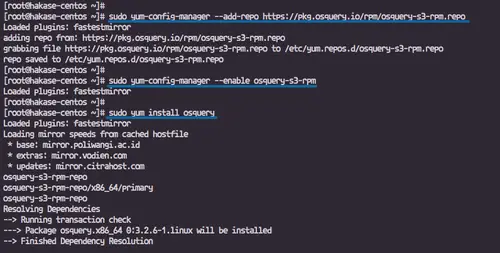

On CentOS
Add the osquery key to the system.
curl -L https://pkg.osquery.io/rpm/GPG | sudo tee /etc/pki/rpm-gpg/RPM-GPG-KEY-osquery
Add and enable the osquery repository, and install the package.
sudo yum-config-manager --add-repo https://pkg.osquery.io/rpm/osquery-s3-rpm.repo
sudo yum-config-manager --enable osquery-s3-rpm
sudo yum install osquery -y

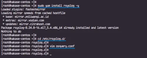

Install the rsyslog package using the yum command below.
sudo yum install rsyslog -y
After the installation is complete, go to the ‘/etc/rsyslog.d’ directory and create a new configuration file osquery.conf.
cd /etc/rsyslog.d/
vim osquery.conf

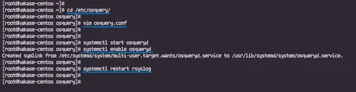

Now start the osqueryd daemon service and enable it to launch every time at system boot.
systemctl start osqueryd
systemctl enable osqueryd
And restart the rsyslog service.
systemctl restart rsyslog

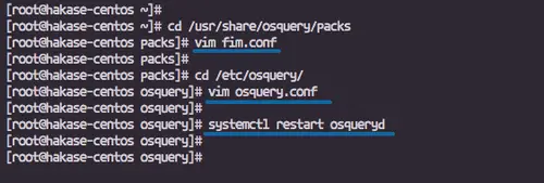

Now back to the ‘/etc/osquery’ configuration directory and edit the osquery.conf file.
cd /etc/osquery/
vim osquery.conf

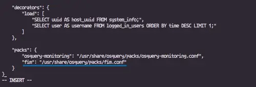

Add the File Integrity Monitoring packs configuration inside the ‘packs’ section.
    "packs": {
        "osquery-monitoring": "/usr/share/osquery/packs/osquery-monitoring.conf",
        "fim": "/usr/share/osquery/packs/fim.conf"
Save and exit, then restart the osqueryd service.
systemctl restart osqueryd

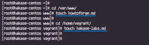

We will test the File Integrity Monitoring packs by creating a new file on the defined directory ‘home’ and ‘www’.
Go to the ‘/var/www/’ directory and create a new file named ‘howtoforge.md’.
cd /var/www/
touch howtoforge.md
Go to the ‘/home/youruser/’ directory and create a new file named ‘hakase-labs.md’.
cd /home/vagrant/
touch hakase-labs.md

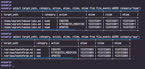

Now check all logs about file changes in the ‘file_events’ table.
For global changes.
select * from file_events;
For ‘home’ directory.
select target_path, category, action, atime, ctime, mtime from file_events WHERE category="home";
For the ‘www’ web root directory.
select target_path, category, action, atime, ctime, mtime from file_events WHERE category="www";

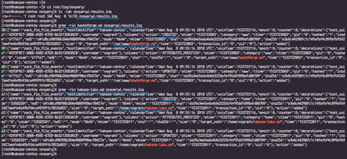

osqueryd results log
Go to the ‘/var/log/osquery’ directory and you will get the ‘osqueryd.results.log’ file.
cd /var/log/osquery/
ls -lah osqueryd.results.log
Filter the osquery logs using the ‘grep’ command.
grep -rin howtoforge.md osqueryd.results.log
grep -rin hakase-labs.md osqueryd.results.log
You will see info about those file has been created.
