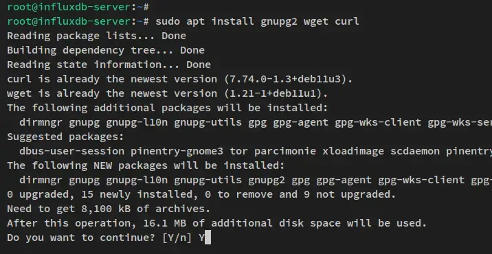

To start, run the below apt command to install some package dependencies to your Debian server. When prompted for the installation, input y and press ENTER.
sudo apt install gnupg2 wget curl

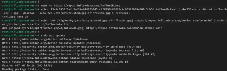

Now add the influxdb repository to your system via the below command. In this example, you will install influxdb from the stable branch repository.Ezoic
echo 'deb [signed-by=/etc/apt/trusted.gpg.d/influxdb.gpg] https://repos.influxdata.com/debian stable main' | sudo tee /etc/apt/sources.list.d/influxdata.list
After that, update and refresh your package index via the apt command below.

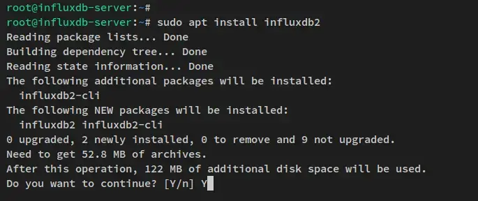

After the repository is added and the package index updated, run the apt command below to install the influxdb2 and influxdb2-cli packages. At the time of this writing, the latest stable version of influxdb is v2.xx and the influxdb-cli is v2.xx.
sudo apt install influxdb2 influxdb2-cli
When prompted for the configuration, input y and press ENTER to proceed.

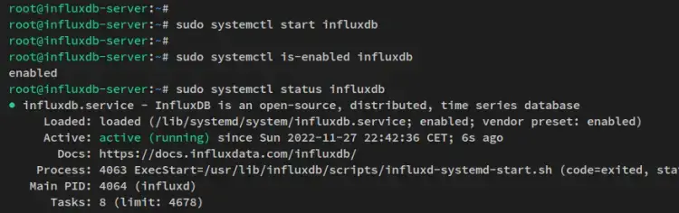

After influxdb2 and influxdb2-cli is installed, use the systemctl uitility command below to start the influxdb service.
sudo systemctl start influxdb
Lastly, verify the influxdb service using the systemctl utility command below.
sudo systemctl is-enabled influxdb
sudo systemctl status influxdb
You should receive the output of the influxdb service is enabled and will be run automatically upon the bootup. And the status of the influxdb service is running.

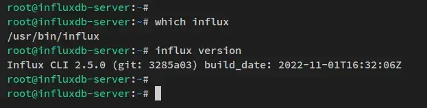

To verify the influxdb2-cli, run the below command on your terminal. The first command will check the full binary path of the ‘influx‘ command, and the second command will verify the version of influxdb2-cli that is installed on your system.
which influx
influx version
You will receive the output like the following screenshot – the ‘influx‘ command is available at ‘/bin/influx‘ and the version of the influxdb2-cli package that was installed is v2.xx.

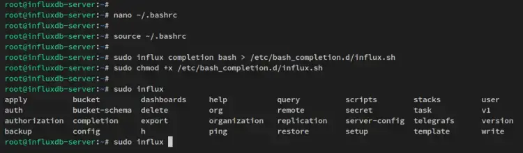

Lastly, type the ‘influx‘ command on your terminal and press TAB to get available options for the ‘influx‘ command.
sudo influx TAB
You will then receive the output like the following.

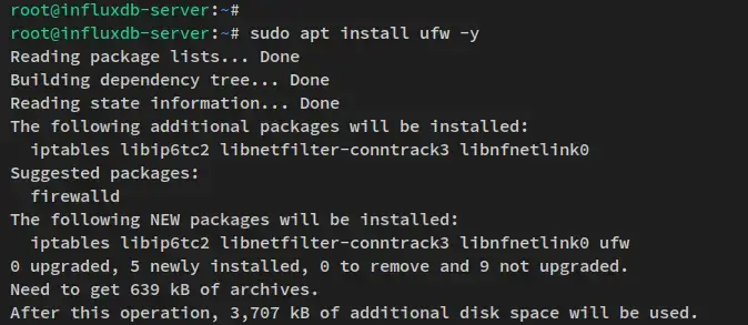

The ufw package isn’t installed on the default Debian installation. Install ufw via the apt command below.
sudo apt install ufw -y

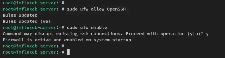

After the ufw package is installed, run the ufw command below to add the OpenSSH service and enabled the ufw firewall service.
sudo ufw allow OpenSSH
sudo ufw enable
When prompted for confirmation, input y and press ENTER. The ufw service should now be started and enabled and will be run automatically upon the bootup.

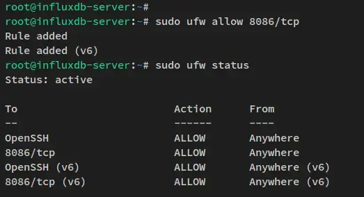

Next, run the below command to add port ‘8086‘ to the ufw firewall. Then, verify the current status of ufw firewall.
sudo ufw allow 8086/tcp
sudo ufw status
You’ll receive the output like the following screenshot – The ufw firewall status is active with the enabled service OpenSSH and port ‘8086‘.

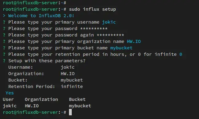

In this step, you will set up the influxdb via the influx command provided by the influxdb2-cli package. Run the below command to start configuring influxdb.
sudo influx setup
Now you will be asked for some configuration of influxdb. Input the username and password for your influxdb installation. Input the default organization name and the default bucket/database.
This example on the below screenshot shows user for the influxdb installation is ‘jokic‘ with the organization name as ‘HW.IO‘ and the default bucket is ‘mybucket‘.

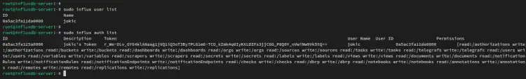

After the influxdb is configured, run the below influx command to verify the configuration.
sudo influx user list
sudo influx auth list
You’ll receive an output similar to the screenshot below. The ‘influx setup‘ command also automatically configured the token for the new admin user with some default admin permissions.

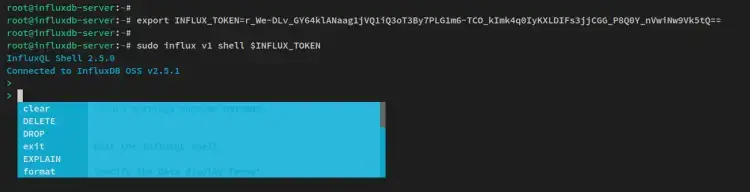

Run the below command to create a new environment variable ‘INFLUX_TOKEN‘. And be sure to change the token with your generated token.
export INFLUX_TOKEN=r_We-DLv_GY64klANaag1jVQ1iQ3oT3By7PLG1m6-TCO_kImk4q0IyKXLDIFs3jjCGG_P8Q0Y_nVwiNw9Vk5tQ==
Now access the influxdb shell via the influx command below.
sudo influx v1 shell $INFLUX_TOKEN
After logged in, you’ll receive a message such as ‘Connected to InfluxDB OSS v2.5.1’.

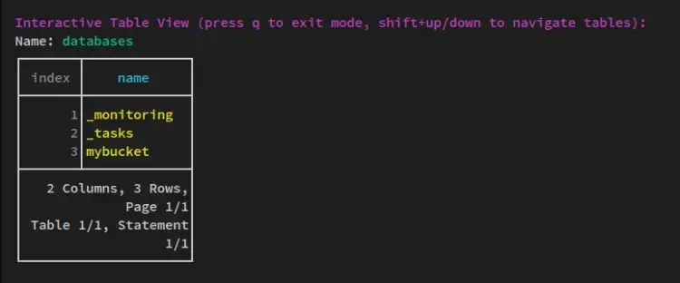

Run the following query to verify the list of buckets/databases on your inlfuxdb installation. The following terminal screen show you the bucket ‘mybucket‘ is available on the influxdb.
show DATABASES
Now input ‘q‘ to exit from the interactive screen. Then type ‘quit‘ to exit from the influxdb shell.

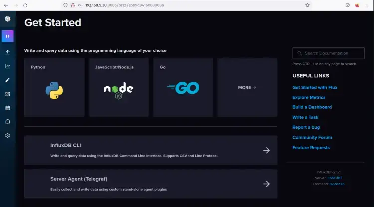

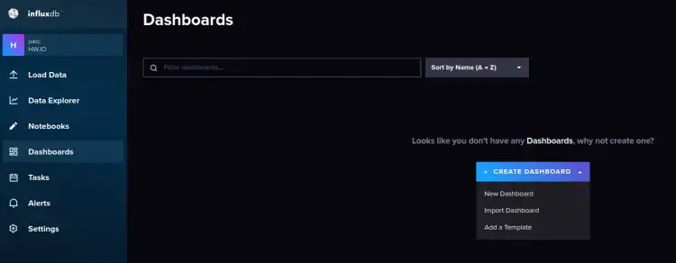

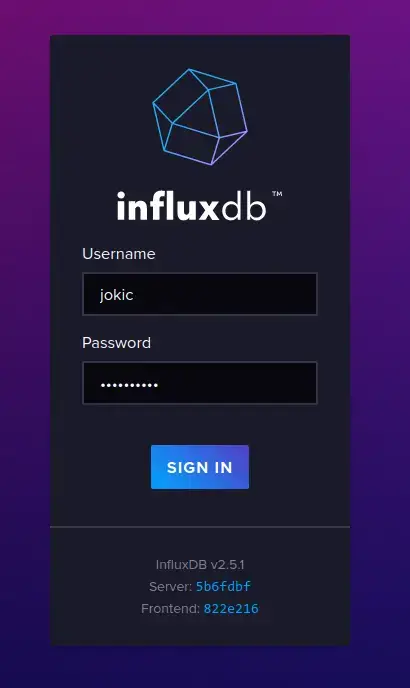

Next, open your web browser and visit your server IP address followed by the default port 8086 (i.e: http://192.168.5.8086/). You will see the influxdb login page.
Input your admin user and password and click ‘SIGN IN’.
You’ll now get the influxdb administration dashboard.

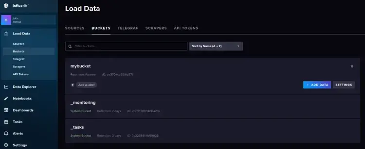

To verify the list of buckets/databases on the influxdb, click on the Load Data > Buckets, and you will see the bucket ‘mybucket‘ is available on the influxdb.
At this point, you have installed and configured the influxdb with basic installation and configuration. You’ll next secure the influxdb via SSL/TLS certificates and update the default profile for the ibnfluxdb2-cli.

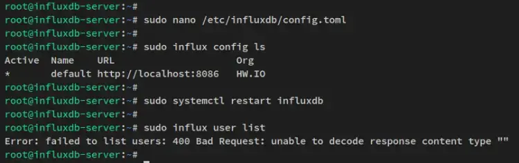

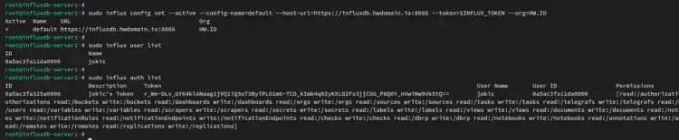

Run the below influx command to verify the list of profiles on the influxdb2-cli and run the query to verify the list of users on the influxdb.
sudo influx config ls
You should see an error message such as ‘failed to list users: 400 Bad Request..‘.
To solve the authentication issue, you must update the ‘default‘ profile and change the default host/URL of the influxdb to the secure HTTPS connection.
Run the below command to update the ‘default‘ profile to the secure influxdb host ‘https://influxdb.howtoforge.local:8086‘.
sudo influx config set --active --config-name=default --host-url=https://influxdb.howtoforge.local:8086 --token=$INFLUX_TOKEN --org=HW.IO
Now verify the new update ‘default‘ profile via the influx command below.
You should now be able to communicate again with the influxdb via the influx command. And the connection between the influx command to the influxdb is secured with SSL/TLS certificates.

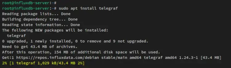

Run the following apt command to install telegraf on a Debian server. Be sure that the influxdb repository is added.
sudo apt install telegraf
The telegraf installation should now be running.

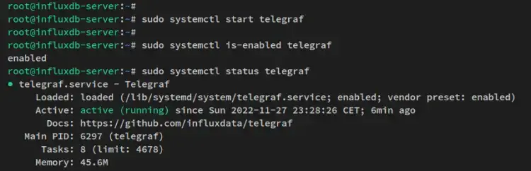

After telegraf is installed, run the below systemctl command utility to start the telegraf service.
sudo systemctl start telegraf
Now verify the telegraf service using the systemctl command utility below and be sure that the service is enabled and running.
sudo systemctl is-enabled telegraf
sudo systemctl status telegraf
In your terminal screen, you’ll receive the output like the following screenshot – The telegraf service is currently running and it’s enabled, which means the telegeraf service will start automatically upon the bootup.

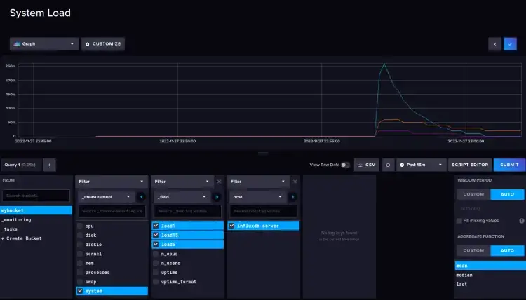

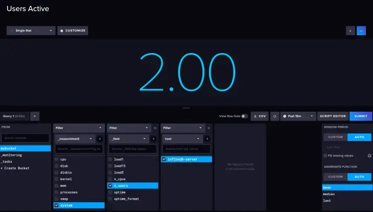

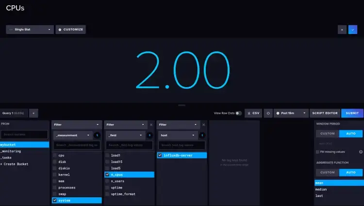

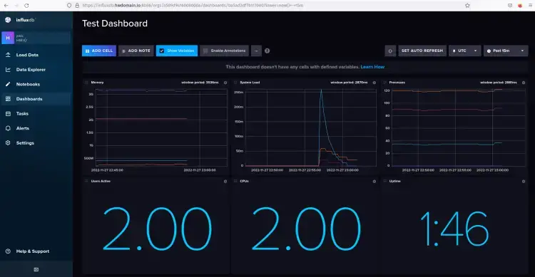

With the telegraf restarted and the changes is applied, you’ll next verify the telegraf installation, which you can do via the influxdb administration dashboard or via the influxdb shell.

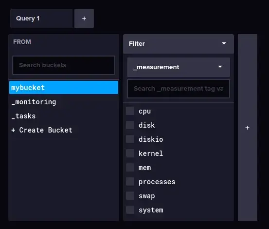

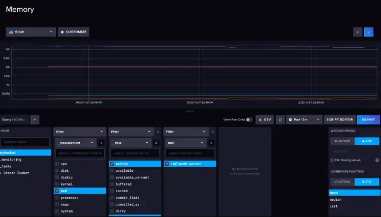

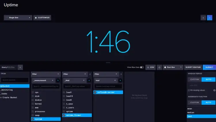

Back to the influxdb administration dashboard, click on the Data Explorer menu, and select the bucket ‘mybucket‘. You should see a list of telegraf metrics is available on the influxdb.

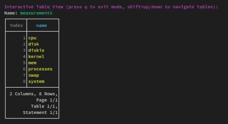

To verify from the influxdb shell, run the below command on the influxdb terminal server.
After logging in to the influxdb shell, run the following queries to verify telegraf metrics. The first query is to switch to the bucket ‘mybucket‘, and the second query is to show available columns/measurements on the bucket.
use mybucket
SHOW MEASUREMENTS
Below is the similar output you’ll receive on your terminal server – Telegraf metrics that include, the cpu, disk, diskio, kernel, mem, processes, swap, and the system is available on the influxdb server.
You have now verified that metrics from the telgeraf server is available on the influxdb server. This means that the telegraf installation and configuration is finished and successful.

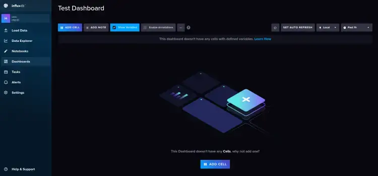

Click on the Dashboard menu, then click ‘Create Dashboard
Input the dashboard name on the top of the page, this example uses the dashboard name ‘Test Dashboard’.
Now click ‘ADD CELL’ to add a new graph for the system monitoring.
Below is the graph for memory monitoring.
System Load monitoring.
Uptime of the target server.
Available CPUs on the target system with the X number.
And lastly, the current user that logged on to the target machine.
After cells is created, below is the result of the example of dashboard creation on influxdb for system monitoring. All of those metrics are gathered by the telegraf and sent all metrics to the influxdb servers.
