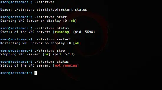

Then, run the script.
user@hostname:~$ ./startvnc
Usage: ./startvnc start|stop|restart|status
This script will only work, if you have a .vnc directory in your home and created a vncpasswd (it checks for ~/.vnc/passwd file). We already created the .vnc directory and the password earlier.
To start the vnc server on the actual display, just type:
user@hostname:~$ ./startvnc start
Starting VNC Server on display :0 [ok]
You can test, if your vnc server is running with the option:
user@hostname:~$ ./startvnc status
Status of the VNC server: [running] (pid: 1328)

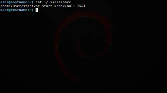

If you want to access the active desktop session automatically, you need to edit the .xsessionrc file in your home directory.
user@hostname:~$ echo "/home/user/startvnc start >/dev/null 2>&1" >> ~/.xsessionrc
 Replace user by your username and it will automatically run when starting the X session. The script logs its activity in ~/.vnc/logfile, if something goes wrong, you can check the log file there.
