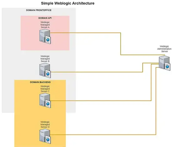

1. Preliminary Note
For this tutorial, I’ll be using CentOS 7.4 in 64bit version. Please note that even though the configuration is made under CentOS 7, yet the steps and modification are mainly the same when using RedHat or Oracle Linux flavor. The reason I’ve mentioned this is most production installations for Oracle Weblogic will use Oracle Linux itself as the operating system.

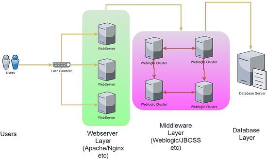

By the end of this tutorial, we will have managed to bring up 2 server nodes that will act as Weblogic Managed Servers which were created by a Weblogic Admin Server. Apart from that, we will be using the Admin Server dashboard to combine both Managed Servers into a cluster group.

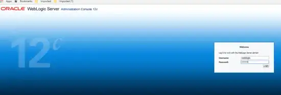

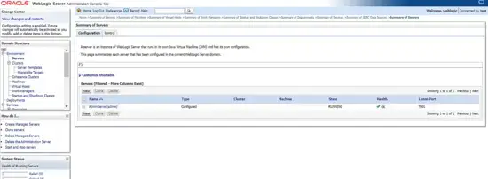

Great, now we’ve done the configuration for both, now let’s start the weblogic and TEST services on admin server. Below are the steps:
 [shahril@weblogic_mgr bin]$ cd $DOMAIN_HOME
[shahril@weblogic_mgr TEST]$ cd bin/
[shahril@weblogic_mgr bin]$ pwd
/home/shahril/wls/oracle/config/domains/TEST/bin
[shahril@weblogic_mgr bin]$ ./startWebLogic.sh &
[1] 19303
JAVA Memory arguments: -Xms256m -Xmx512m -XX:CompileThreshold=8000 -XX:PermSize=128m -XX:MaxPermSize=256m
CLASSPATH=/usr/java/jdk1.8.0_131/lib/tools.jar:/home/shahril/wls/oracle/product/fmw12/wlserver/server/lib/weblogic_sp.jar:/home/shahril/wls/oracle/product/fmw12/wlserver/server/lib/weblogic.jar:/home/shahril/wls/oracle/product/fmw12/oracle_common/modules/net.sf.antcontrib_1.1.0.0_1-0b3/lib/ant-contrib.jar:/home/shahril/wls/oracle/product/fmw12/wlserver/modules/features/oracle.wls.common.nodemanager_2.0.0.0.jar:/home/shahril/wls/oracle/product/fmw12/oracle_common/modules/com.oracle.cie.config-wls-online_8.1.0.0.jar:/home/shahril/wls/oracle/product/fmw12/wlserver/common/derby/lib/derbyclient.jar:/home/shahril/wls/oracle/product/fmw12/wlserver/common/derby/lib/derby.jar:/home/shahril/wls/oracle/product/fmw12/wlserver/server/lib/xqrl.jar .
PATH=/home/shahril/wls/oracle/product/fmw12/wlserver/server/bin:/home/shahril/wls/oracle/product/fmw12/oracle_common/modules/org.apache.ant_1.9.2/bin:/usr/java/jdk1.8.0_131/jre/bin:/usr/java/jdk1.8.0_131/bin:/usr/java/jdk1.8.0_131/bin:/usr/java/jdk1.8.0_131/bin:/usr/java/jdk1.8.0_131/bin:/usr/local/bin:/bin:/usr/bin:/usr/local/sbin:/usr/sbin:/home/shahril/bin:/home/shahril/bin:/home/shahril/bin .
* To start WebLogic Server, use a username and *
* password assigned to an admin-level user. For *
* server administration, use the WebLogic Server *
* console at http://hostname:port/console *

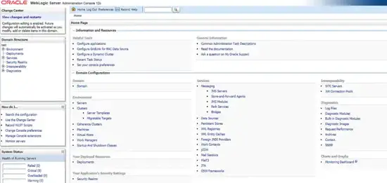

Now, let’s open up our admin dashboard via http://172.17.0.6:7001/console . As mentioned before, for this test, we are’ve just creating only 1 DOMAIN which is TEST therefore the default port 7001 are dedicated for this domain. For multiple domains, the configuration can be seperated by its own dedicated port. Once you have launched the URL in the browser, you should see the console like below, enter the username and password that we’ve defined during configuration above. For this test, it’s weblogic/Test1234 :-
Once you have login successfully, you will see a complete dashboard like shown below:

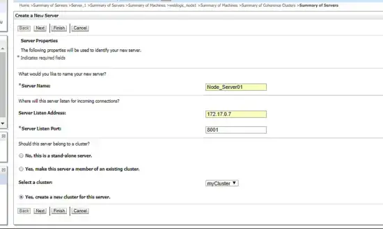

To proceed with our test, from the dashboard click on Environment -> Servers tab . You will see the results as shown like below which automatically the Weblogic Admin server already included inside TEST domain.

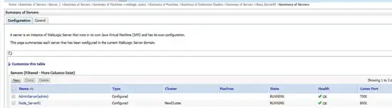

Next, click on the button  , it will forward you to page below. Fill in the Weblogic Managed Server information like it’s IP addresses and the weblogic port as per shown then click next.

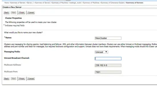

After that, define the new cluster name you want to the click next. Remain others as per default like example below:

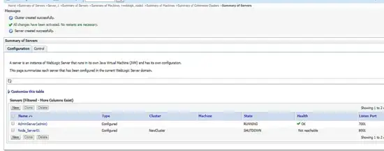

Great, now you’ve include an instance node inside your newly created weblogic cluster. Below are the example snapshot:
Now, let’s bring up the instance node. For this case, we’ll go back to CLI shell and start up the weblogic managed server like command we use before like below:

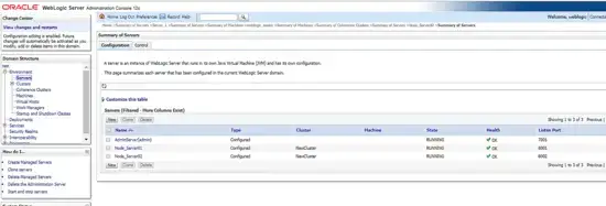

Once done, go back to admin URL and refresh the dashboard. You will see that now the instance node you’ve established are up and running. Below is the example screenshot:
Next, use the same process to add another Weblogic Managed Server into the defined cluster. As the final result, you will see all instance nodes you’ve added are up and running and in load balancing mode. Below is the example result:
Congratulations! Now you’ve successfully created a new weblogic cluster architecture.
