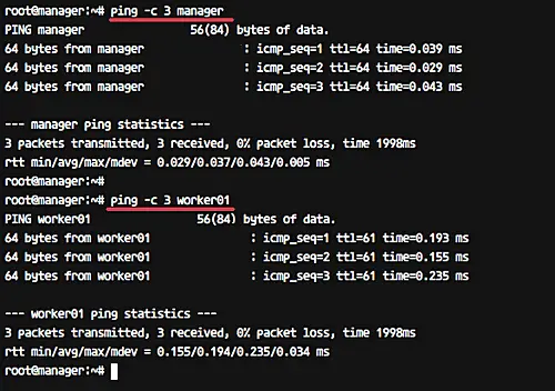

Now ping all the nodes using ‘hostname’ instead using IP address.
ping -c 3 manager
ping -c 3 worker01
And make sure it’s working at all hosts.

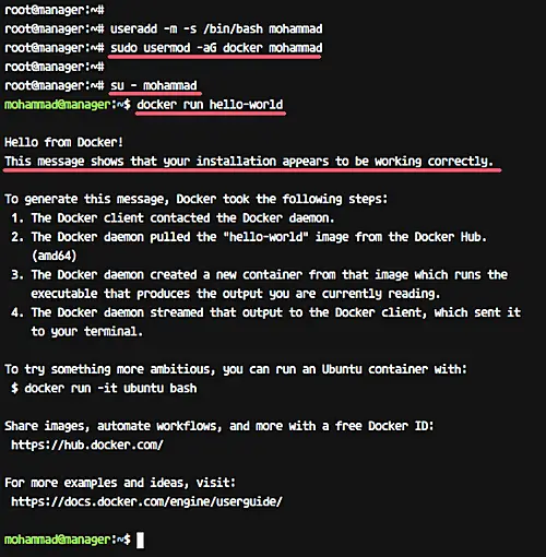

Next, we will configure docker to run as a normal user or non-root user.
Create a new user named ‘mohammad’ and add it to the ‘docker’ group.
useradd -m -s /bin/bash mohammad
sudo usermod -aG docker mohammad
Now login to the ‘mohammad’ user and run the docker hello-world command as below.
su - mohammad
docker run hello-world
And you will get the hello world from docker as shown below.AdvertisementEzoic

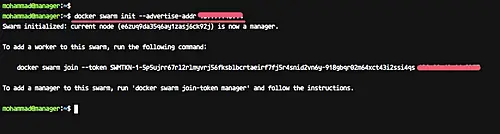

Step 3 – Create the Swarm Cluster
In this step, we will create the Swarm Cluster of our nodes. And in order to create the swarm cluster nodes, we need to initialize the swarm mode on the ‘manager’ node and then join the ‘worker01’ node to the cluster.
Initialize the Docker Swarm mode by running the docker command below on the ‘manager’ node.
docker swarm init --advertise-addr 132.92.41.4
And you will get the result as shown below.
You will see ‘join-token’ has been generated by the ‘manager’ node.

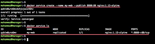

Step 4 – Deploying First Service to the Cluster
In this step, we will create and deploy our first service to the swarm cluster. We want to create new service Nginx web server that will run on default http port 80, and then expose it to the port 8080 on the host server, and then try to replicate the nginx service inside the swarm cluster.
Create Service
Create new Nginx service named ‘my-web’ and expose the HTTP port of the container to the port 8080 on the host.
docker service create --name my-web --publish 8080:80 nginx:1.13-alpine
And when it’s created, check using docker service command below.
docker service ls
The Nginx service has been created and deployed to the swarm cluster as a service named ‘my-web’, it’s based on the Nginx Alpine Linux, expose the HTTP port of the container service to the port ‘8080’ on the host, and it has only 1 replicas.

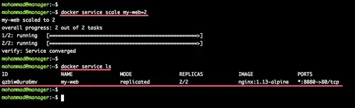

Replicas and Scale the Service
Now we will make replicas for the ‘my-web’ service. We will make 2 replicas of the ‘my-web’ service, so the service is accessible on the ‘manager’ and ‘worker01’ nodes.
To replicate the ‘my-web’ service, run the following command.
docker service scale my-web=2
And after it’s complete, check again using docker service command.
docker service ls
And now the server has 2 replicates.

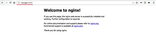

Open your web browser and type the manager node IP address with port 8080.
http://manager:8080/
And you will get the Nginx default page.

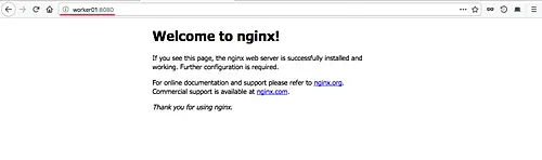

Below is the result from the ‘worker01’ node.
http://worker01:8080/
The Swarm Cluster has been created, and the Nginx service has been completed deployed to our Swarm Cluster.
