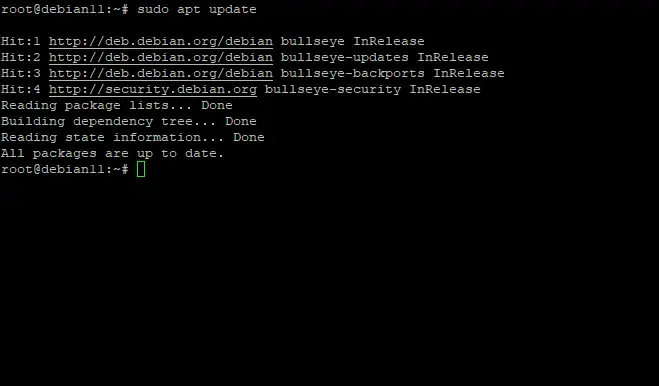

Before installing nginx, you need to update the system so that it is up to date. You should also install additional required packages needed for compiling third party modules. Run the following commands to update the system and install the required packages:
sudo apt update -y
sudo apt upgrade -y
sudo apt install curl gnupg2 ca-certificates lsb-release
You should receive the following output:
debian 11 update
debian 11 update
