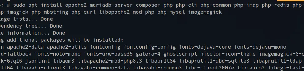

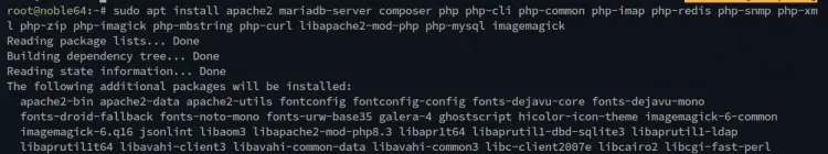

Now install dependencies for Neos CMS with the command below. In the following, you will be installing LAMP Stack (Linux, Apache, MySQL/MariaDB, and PHP), Composer, Git, and ImageMagick packages.
sudo apt install apache2 mariadb-server composer git php php-cli php-common php-imap php-redis php-snmp php-xml php-zip php-imagick php-mbstring php-curl libapache2-mod-php php-mysql imagemagick
Input Y to confirm the installation.Ezoic

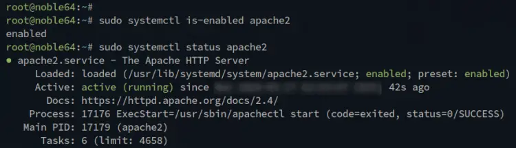

Check the Apache web server with the following. You will see that the service is enabled and active(running).
sudo systemctl is-enabled apache2
sudo systemctl status apache2

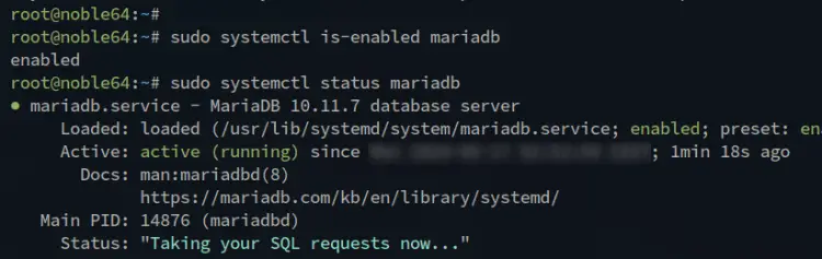

Now check the MariaDB service status with the following – You will see a similar output. The MariaDB is enabled and active(running).
sudo systemctl is-enabled mariadb
sudo systemctl status mariadb

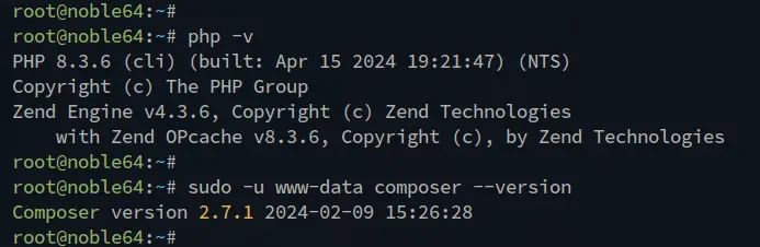

Lastly, check the PHP and Composer versions using the command below. PP 8.3 and Composer 2.7 are installed on your Ubuntu system.
php -v
sudo -u www-data composer -vAdvertisementEzoic

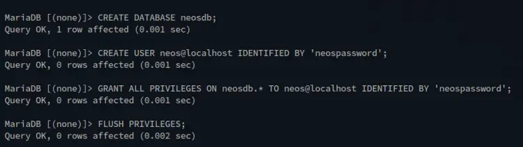

Now run the following queries to create a new database and user for Neos CMS. In this example, you will create a new database neosdb, a user neos with the password neospassword. You can adjust that information with yours.
CREATE DATABASE neosdb;
CREATE USER neos@localhost IDENTIFIED BY ‘neospassword’;
GRANT ALL PRIVILEGES ON neosdb.* TO neos@localhost IDENTIFIED BY ‘neospassword’;
FLUSH PRIVILEGES;

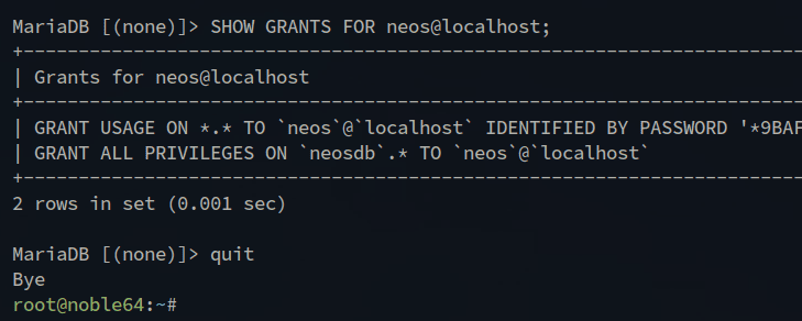

Next, run the query below to check privileges for the user neos. Make sure that the user neos can access the database neosdb.
SHOW GRANTS FOR neos@localhost;
Lastly, type quit to exit from the MariaDB server.

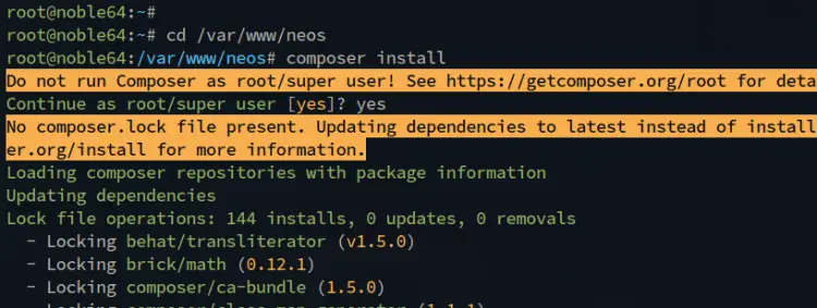

Move to the /var/www/neos directory and install Neos CMS dependencies with the composer command below.
cd /var/www/neos
composer install
As for now, enter yes to confirm and run Composer as root.

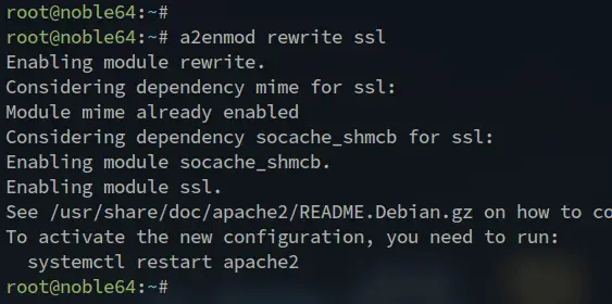

Enable the rewrite and ssl modules for Apache with the command below.
sudo a2enmod rewrite ssl

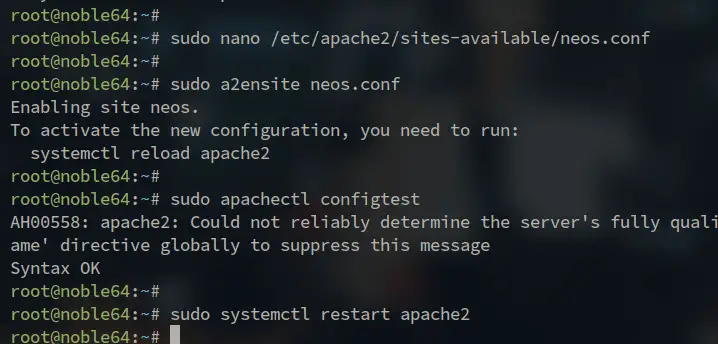

Next, run the command below to activate the virtual host file neos.conf and verify your Apache syntax. If you have correct and proper Apache syntax, you will get an output Syntax is OK.
sudo a2ensite neos.conf
sudo apachectl configtest
Lastly, run the following to restart the Apache web server and apply your changes. Once restarted, your Neos CMS should be ready.

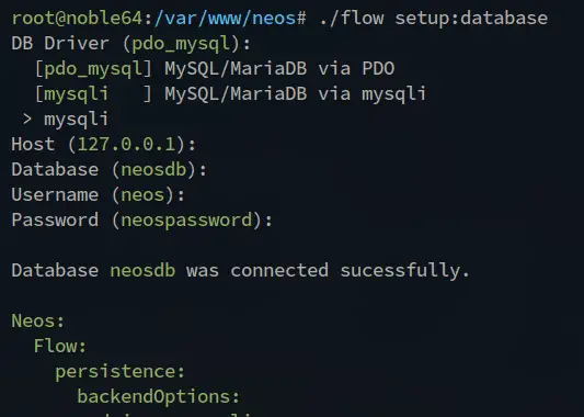

Run the command below to set up a database for Neos CMS. Select mysqli as the database driver and enter your details MariaDB database and user that you’ve created.
sudo ./flow setup:database
When successful, you will see an output such as Database neosdb was connected successfully.

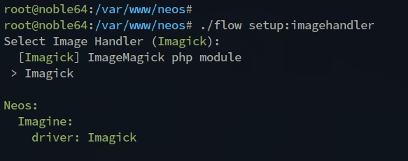

Now run the command below to set up the default image handler for Neos CMS and select Imagick.
sudo ./flow setup:imagehandler

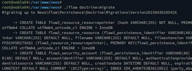

After configuring the database and image handler, run the command below to migrate the Neos CMS database.
sudo ./flow doctrine:migrate
You can see the following output during database migration.

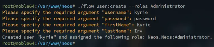

Next, run the following to create an administrator user for your Neos CMS installation. Enter your username, email address, first name, last name, and your password.
sudo ./flow user:create –roles administrator
You will get an output like the following:

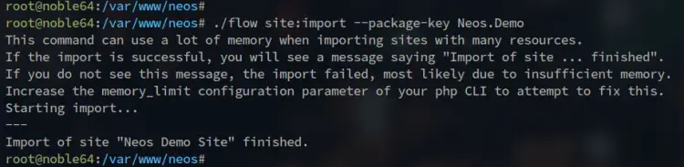

Now run the command below to import the Neos.Demo site to your installation. if successful, you will get an output Import of site "Neos Demo site" finished.
sudo flow:cache:flush
sudo ./flow site:import –package-key Neos.Demo

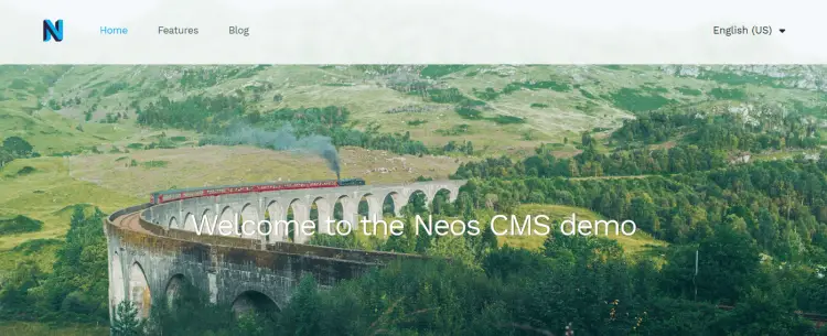

With this, the Neos CMS is complete. Visit your domain name such as https://howtoforge.local and you will get the Neos CMS home page like the following:

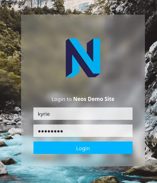

To access the Neos CMS login page, visit https://howtoforge.local/login and input your admin user and password that you’ve created. Click Login to confirm.

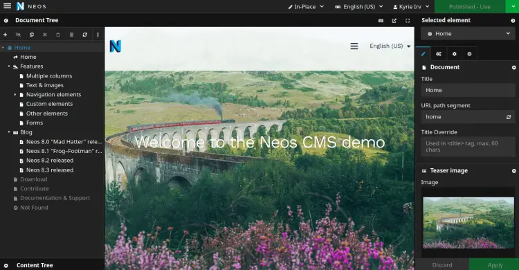

If you have proper admin credentials, you will see the Neos CMS dashboard like the following:
