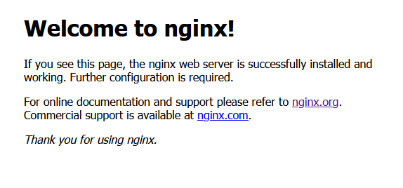

Open your server’s IP address in your web browser. You should see the following page which means your server is up and running.AdvertisementEzoic

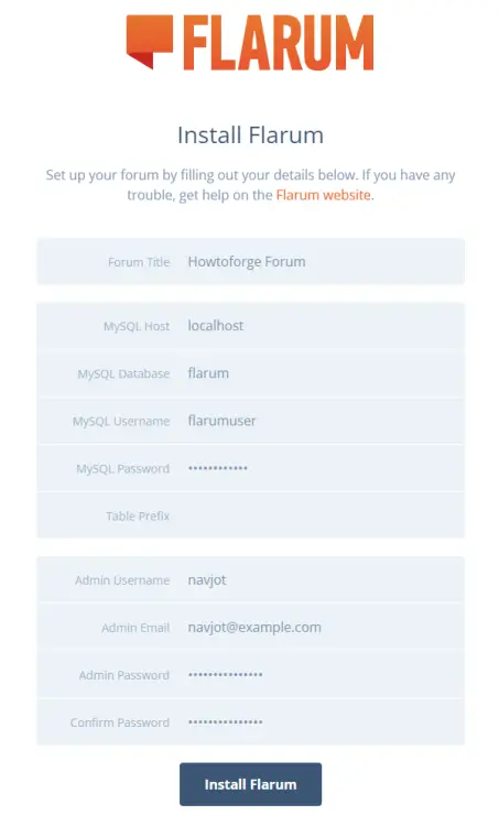

Create a new MySQL database, database user, and password for your Flarum installation.
MariaDB> CREATE DATABASE flarum;
MariaDB> CREATE USER 'flarumuser'@'localhost' IDENTIFIED BY 'yourpassword';
MariaDB> GRANT ALL PRIVILEGES ON flarum.* TO 'flarumuser'@'localhost';

Open http://example.com in your browser to complete the installation.
Fill in the required database values we created above. You can leave the Table Prefix entry blank to allow Flarum to use the default prefix or you can enter any custom prefix like fla_. Choose a username, strong password, and email ID to install Flarum.
Click the Install Flarum button to finish the installation.

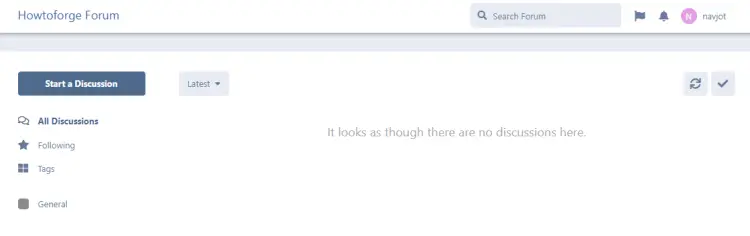

Once installed, you should be greeted with the default Flarum homepage.
Your forum is now installed and ready for use.

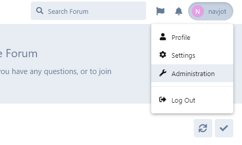

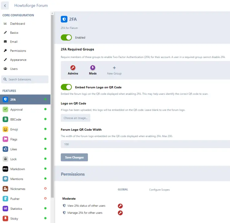

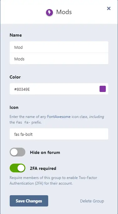

The next step is to enable the plugin from the Flarum administration panel. Click your name on the top right of the homepage and click on the Administration link from the drop-down menu.
You will be taken to the administration dashboard. Select the 2FA feature from the left menu and turn it on. You don’t need to change anything as the default settings should work fine.
If you want moderators on the forum to have 2FA enabled, click the Mods button and enable the 2FA required setting. Click the Save Changes button to finish.

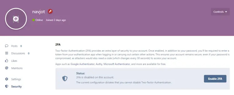

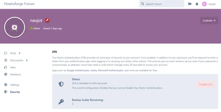

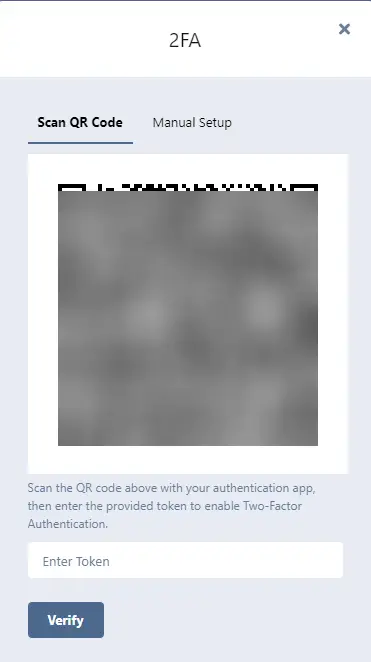

To enable 2FA for your account, open your settings page from the top right menu on the forum homepage. Open the Security page by selecting from the left sidebar.
Click the Enable 2FA button and the following popup will open.

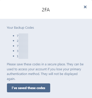

Scan the QR code or choose the manual option using your 2FA app and enter the code generated in the box. Click the Verify button when finished. You will be shown backup codes. Save them and click the button to proceed.
You will be asked for confirmation again. Click the Ok button to proceed. The process is now complete.

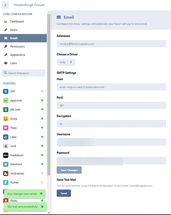

You will also need to configure mail settings from the Administration panel. Flarum supports Mailgun SMTP service natively or you can use an external SMTP provider.
We are using Amazon SES service for which we have selected smtp from the email driver drop-down menu on the email page. Click the Save Changes button.
Before sending a test mail, you will need to install a composer package to make it work. Switch to the Flarum directory on the server.
$ cd /var/www/flarum
Install the composer package.
$ composer require guzzlehttp/guzzle:^7.0

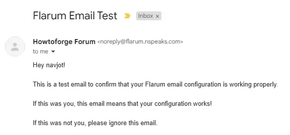

Return to the email settings page and click the Send button to send a test email. The page will notify if the mail was sent successfully. You should get the following mail.

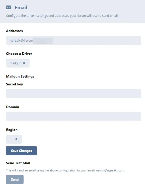

If you want to use Mailgun, choose mailgun from the drop-down menu. Fill in the required fields, and save the settings.

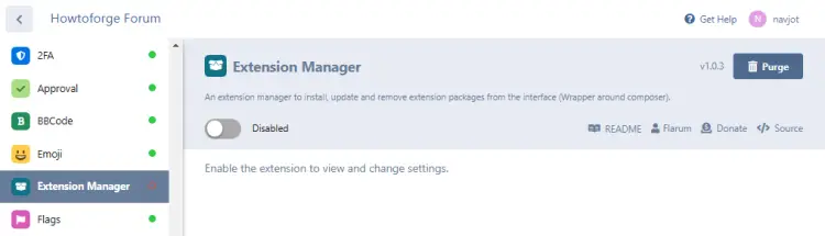

You need to have the Extension Manager extension to be able to update Flarum from within the administration dashboard. Install the Extension Manager using the following command.
$ composer require flarum/extension-manager:*
Open the Administrator dashboard and enable the Extension Manager extension by switching the disabled button to the right.

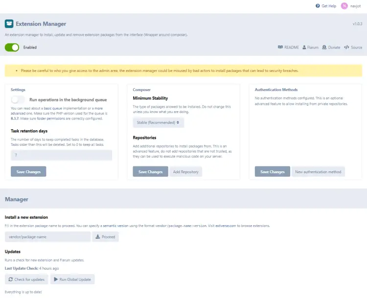

On enabling the extension, it should look like the following.
Before updating the forum, you need to enable the forum’s maintenance mode. The configuration for this is not available via the Administration dashboard. Some of the settings are available via the config.php file in the Flarum’s root directory. Switch to the terminal and open the config.php file for editing.
$ nano /var/www/flarum/config.php
Find the line 'debug' => false, and add the following line after it so that it looks like the following.
'debug' => false,
'offline' => true,
Once finished, press Ctrl + X to close the editor and press Y when prompted to save the file.
Switch back to the dashboard and click the Check for updates button at the bottom page of the Extension manager to update the Flarum software. To use the extension manager to manage extension updates, check the Extension manager documentation.
