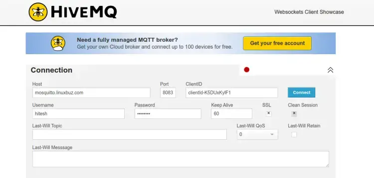

Now, open your web browser and use the browser-based MQTT client to test the WebSockets functionality. You should see the following screen:

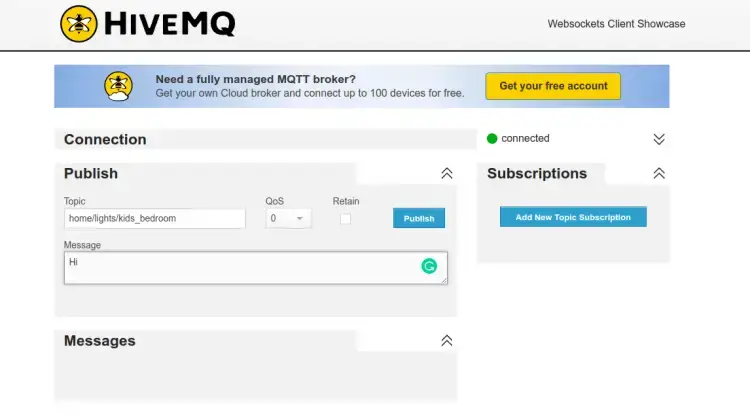

Provide your Mosquitto server host, port, username, password, and click on the Connect button. You should see the following screen:
Now, type any topic, message then click on the Publish button.
Next, go back to the terminal interface. You should see your published message in the following output:
Hi
