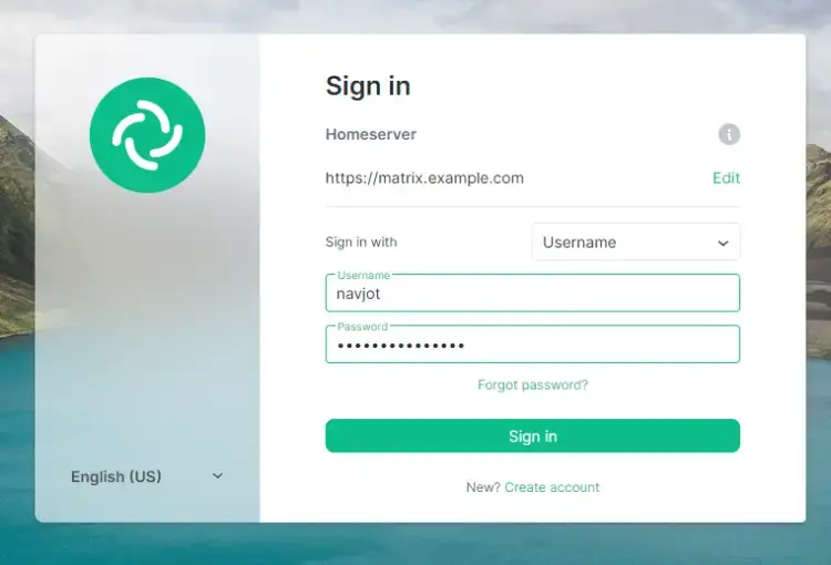

Step 9 – Access Matrix

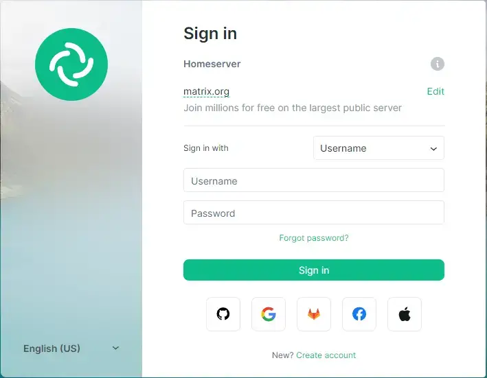

You can access Matrix Chat using Element’s web client at https://app.element.io. Click the Sign in button to proceed.

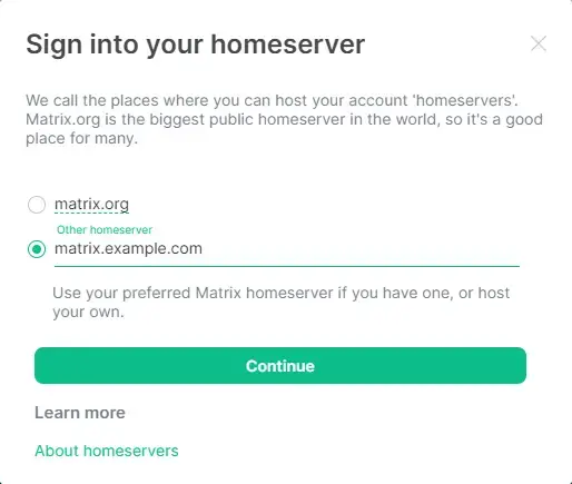

Click the Edit link under Homeserver. Enter matrix.example.com as your homeserver.
If the client detects your homeserver correctly, the boundary and the text will become green colored else it will be shown in red. Click Continue to proceed.

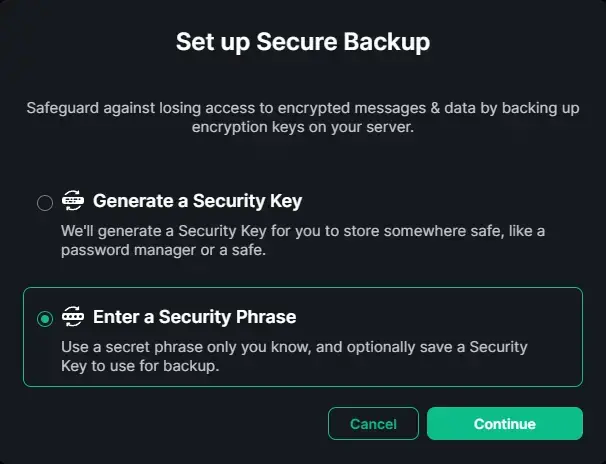

Click the Sign in button to log in. You will be asked to create a secure and encrypted backup.

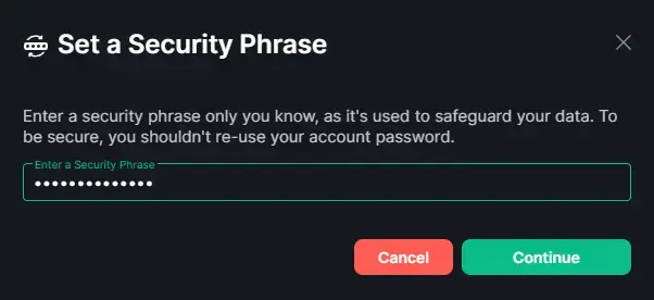

Select the Enter a Security Phrase option to create a security phrase that will be required every time you log in. Click Continue to proceed.

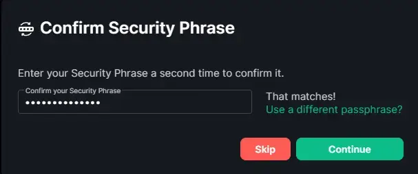

Enter a security phrase and click the Continue button to proceed. You will be asked to confirm it again on the next screen.
Enter the phrase again and click Continue to proceed.

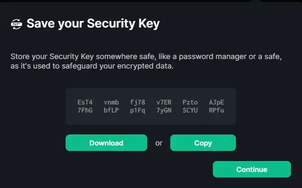

You will be given a set of security keys that you can use if you forget your security phrase. Click the Download button to save them.
Click the Continue button to proceed.

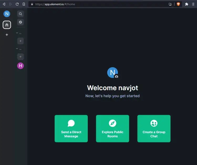

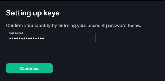

You will be asked for your account password. Enter the password and click the Continue button to finish setting up the encrypted backup.

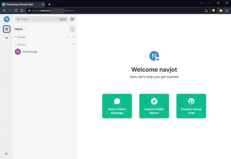

We created a group chat room named Howtoforge as shown above.

You can access the Element client via the URL https://element.example.com in your browser. Log in and you will be taken to the app dashboard.
