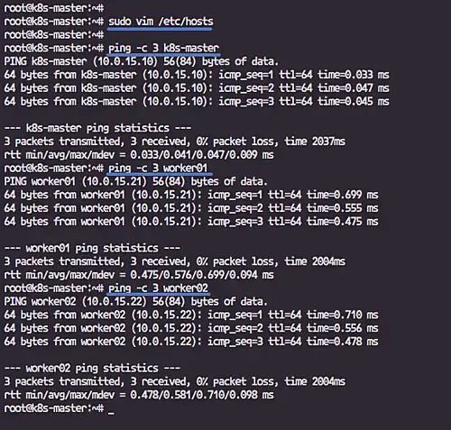

Now test ping all servers hostname.
ping -c 3 k8s-master
ping -c 3 worker01
ping -c 3 worker02
Make sure all IP address get resolved as a hostname.Ezoic

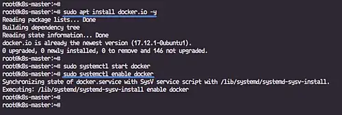

Install Docker
In this tutorial, we will install Docker from the Ubuntu repository.
Install Docker using the apt command below.
sudo apt install docker.io -y
After the installation is complete, start the docker service and enable it to launch everytime at system boot.
sudo systemctl start docker
sudo systemctl enable docker
Docker installation has been completed.

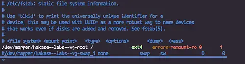

Disable SWAP
In order to set up the Kubernetes Linux servers, we need to disable the SWAP.
Check the swap list and disable it.
sudo swapon -s
sudo swapoff -a
To disable the SWAP permanently, we need to edit the ‘/etc/fstab’ file.
sudo vim /etc/fstab
Make a comment on the SWAP partition type.
#/dev/mapper/hakase--labs--vg-swap_1 none            swap    sw              0       0
Save and exit, then reboot the system.
sudo reboot

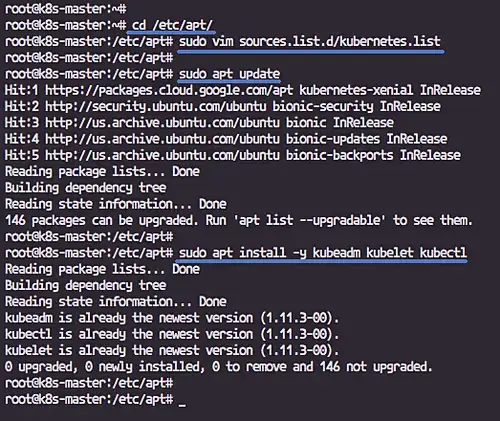

Install Kubeadm Packages
In this tutorial, we will be using Kubeadm packages to set up the Kubernetes Cluster. We will install the Kubeadm packages from the official Kubernetes repository.
Install apt-transport-https.
sudo apt install -y apt-transport-https
Add the Kubernetes Key.
curl -s https://packages.cloud.google.com/apt/doc/apt-key.gpg | sudo apt-key add -
And add the Kubernetes Repository by creating a new repo.list file on the ‘/etc/apt/sources.list.d’ directory.
cd /etc/apt/
sudo vim sources.list.d/kubernetes.list
paste kubernetes repository below.
deb http://apt.kubernetes.io/ kubernetes-xenial main
Note:
We’re still using the Xenial Ubuntu 16.04 repository for our Kubeadm Installation.
Now update the repository and install kubeadm packages using apt commands below.
sudo apt install -y kubeadm kubelet kubectl
Wait for kubeadm packages installations.

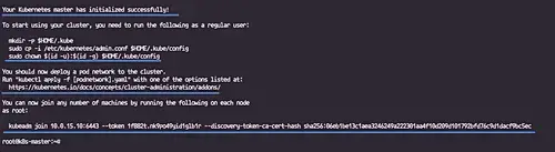

Step 2 – Kubernetes Cluster Initialization
In this step, we will initialize Kubernetes on the ‘k8s-master’ node. Run all commands in this stage only on the ‘k8s-master’ server.
Initialize the Kubernetes cluster using the kubeadm command below.
sudo kubeadm init --pod-network-cidr=10.244.10.0/16 --apiserver-advertise-address=10.0.15.10 --kubernetes-version "1.11.0"
Note:
  • –apiserver-advertise-address = determines which IP address Kubernetes should advertise its API server on.
  • –pod-network-cidr = specify the range of IP addresses for the pod network. We’re using the ‘flannel’ virtual network. If you want to use another pod network such as weave-net or calico, change the range IP address.
When the Kubernetes initialization is complete, you will get the result as shown below.
Copy the ‘kubeadm join … … …‘ command to your text editor. The command will be used to register new worker nodes to the kubernetes cluster.

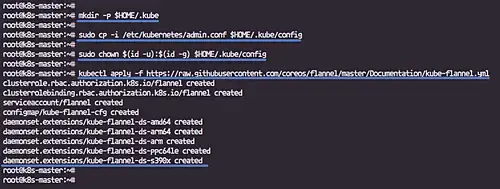

Now in order to use Kubernetes, we need to run some commands as shown in the result.
Create new ‘.kube’ configuration directory and copy the configuration ‘admin.conf’ from ‘/etc/kubernetes’ directory.
mkdir -p $HOME/.kube
sudo cp -i /etc/kubernetes/admin.conf $HOME/.kube/config
sudo chown $(id -u):$(id -g) $HOME/.kube/config
Next, deploy the flannel network to the kubernetes cluster using the kubectl command.
kubectl apply -f https://raw.githubusercontent.com/coreos/flannel/master/Documentation/kube-flannel.yml
The flannel network has been deployed to the Kubernetes cluster.

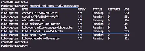

Wait for a minute and then check the Kubernetes node and pods using the commands below to get pods from all namespaces.
kubectl get nodes
kubectl get pods --all-namespaces
And you will get the ‘k8s-master’ node is running as a ‘master’ cluster with status ‘ready’, and all ‘kube-system’ pods that are needed for the cluster is up and running.
Kubernetes cluster master initialization and configuration has been completed.

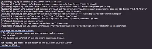

Step 3 – Adding Worker Nodes to the Kubernetes Cluster
In this step, we will add two node workers ‘worker01’ and ‘worker02’ to the Kubernetes Cluster.
Connect to the ‘worker01’ server and run the kubeadm join command that you get from the cluster initialization.
kubeadm join 10.0.15.10:6443 --token daync8.5dcgj6c6xc7l8hay --discovery-token-ca-cert-hash sha256:65a3e69531d323c335613dea1e498656236bba22e6cf3d5c54b21d744ef97dcd
Connect to the ‘worker02’ server and run the kubeadm join command that you get from the cluster initialization.

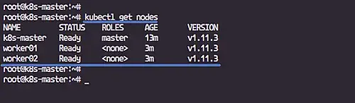

Wait for some minutes and back to the ‘k8s-master’ node master and check node status.
kubectl get nodes
You will see those worker nodes ‘worker01’ and ‘worker02’ are part of the Kubernetes Cluster.

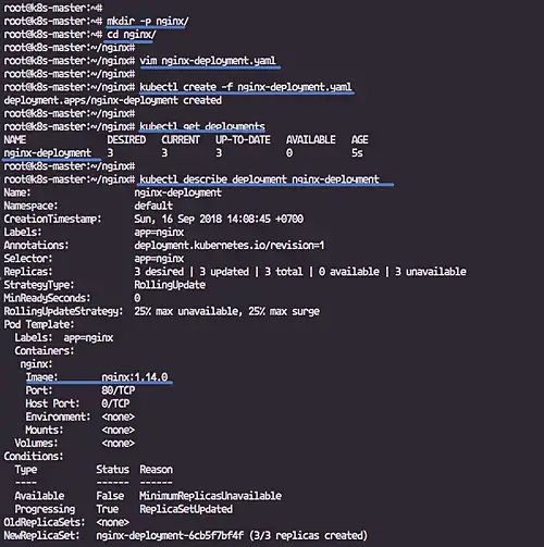

Now create the deployment by running the kubectl command below.
kubectl create -f nginx-deployment.yaml
After creating a new ‘nginx-deployment’, check the deployments list inside the cluster.
kubectl get deployments
kubectl describe deployment nginx-deployment

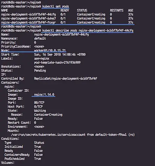

Now check Kubernetes Pods and you will see the ‘nginx-deployment-xxx’ pod, check details of the pod.
kubectl get pods
kubectl describe pods nginx-deployment-6cb5f7bf4f-t5xfh
You will get nginx-deployment pods with 3 replicas on the worker nodes.

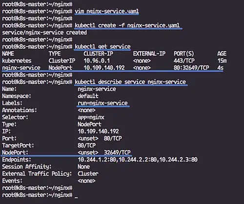

Next, we need to create a new service for our ‘nginx-deployment’.
Create a new YAML file named ‘nginx-service.yaml’.
vim nginx-service.yaml
Paste the configuration below.
apiVersion: v1
kind: Service
metadata:
  labels:
    run: nginx-service
spec:
  type: NodePort
  ports:
  - port: 80
    protocol: TCP
  selector:
    app: nginx
Save and exit.
Note:
  • We’re creating a new kubernetes service named ‘nginx-service’.
  • Type of the service is ‘NodePort’ with the TargetPort HTTP default port 80.
  • The service belongs to the app named ‘nginx’ based on our deployment ‘nginx-deployment’.
Create the kubernetes service using the kubectl command below.
kubectl create -f nginx-service.yaml
Now check all available services on the cluster and you will get the ‘nginx-service’ on the list, then check details of service.
kubectl get service
kubectl describe service nginx-service
And you will see the ‘nginx-service’ NodePort is running on port ‘32649’.

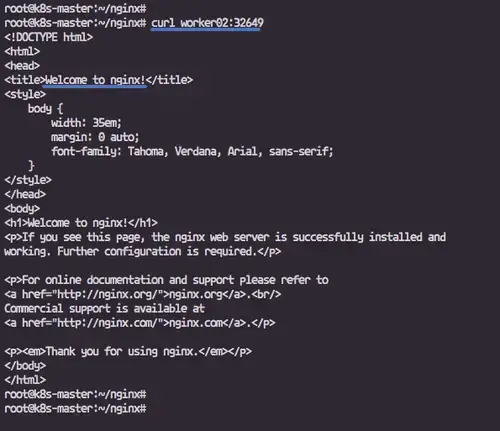

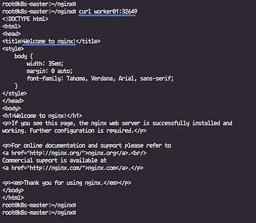

Check using the curl command to all worker nodes.
On the worker01.
curl worker01:32649
You will see the Nginx default page.
On the worker02.
curl worker02:32649
The Kubernetes Cluster installation and configuration on Ubuntu 18.04 has been completed successfully.
