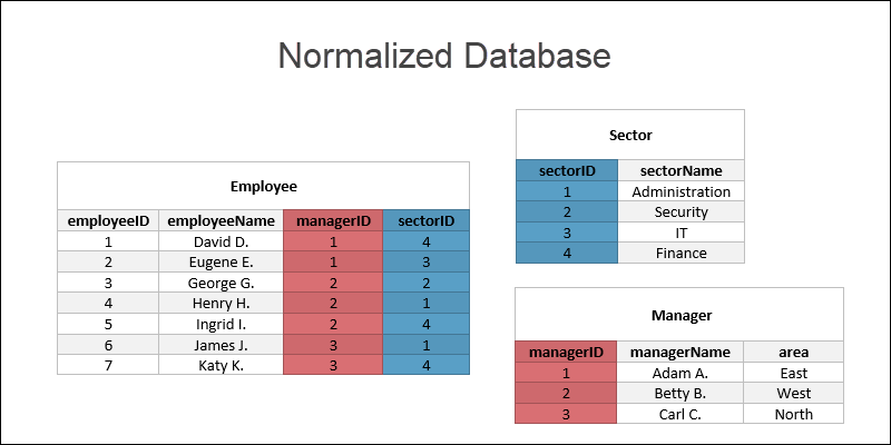

Step 3: Third Normal Form 3NF
The third normal form decomposes any transitive functional dependencies. Currently, the table Employee has a transitive dependency which decomposes into two new tables:
- Employee (employeeID, employeeName, managerID, sectorID)
| employeeID | employeeName | managerID | sectorID |
| 1 | David D. | 1 | 4 |
| 2 | Eugene E. | 1 | 3 |
| 3 | George G. | 2 | 2 |
| 4 | Henry H. | 2 | 1 |
| 5 | Ingrid I. | 2 | 4 |
| 6 | James J. | 3 | 1 |
| 7 | Katy K. | 3 | 4 |
- Sector (sectorID, sectorName)
| sectorID | sectorName |
| 1 | Administration |
| 2 | Security |
| 3 | IT |
| 4 | Finance |
The database is currently in third normal form with three relations in total. The final structure is:
At this point, the database is normalized. Any further normalization steps depend on the use case of the data.
