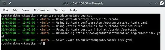

suricata-update update-sources
Will look like this:
This command will updata suricata-update with all of the available rules sources.

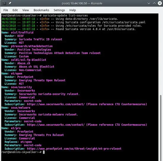

suricata-update list-sources

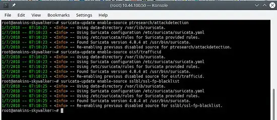

Now we will enable all of the (free) rules sources, for a paying source you will need to have an account and pay for it of course. When enabling a paying source you will be asked for your username / password for this source. You will only have to enter it once since suricata-update saves that information.
suricata-update enable-source ptresearch/attackdetection
suricata-update enable-source oisf/trafficid
suricata-update enable-source sslbl/ssl-fp-blacklist

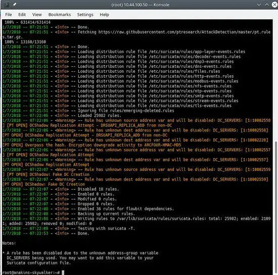

And update your rules again to download the latest rules and also the rule sets we just added.
suricata-update
Will look something like this:

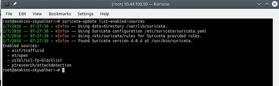

To see which sources are enable do:
suricata-update list-enabled-sources
This will look like this:

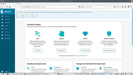

If you go to http://kibana.ip:5601 you will see something like this:

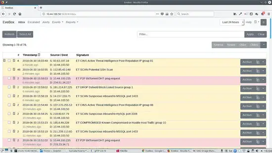

Now we can go to http://localhost:5636 and we see the following:
