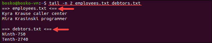

Print Lines from Multiple Files
Work with multiple files at once by passing the file names after the tail command. For example, to print the last two lines of multiple files, use the following syntax:
tail -n 2 [file1] [file2] [file3] …
Print lines from multiple files using tail.
The command prints the last two lines of the two specified files, prepending each one with a header containing the file name.
