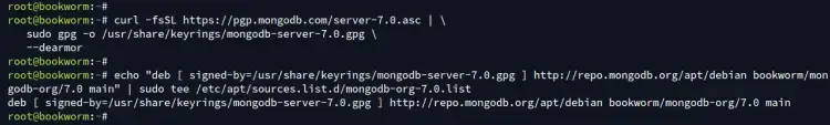

Add the MongoDB GPG key and repository with the following command:
curl -fsSL https://pgp.mongodb.com/server-7.0.asc | \
sudo gpg -o /usr/share/keyrings/mongodb-server-7.0.gpg \
--dearmor
echo "deb [ signed-by=/usr/share/keyrings/mongodb-server-7.0.gpg ] http://repo.mongodb.org/apt/debian bookworm/mongodb-org/7.0 main" | sudo tee /etc/apt/sources.list.d/mongodb-org-7.0.list

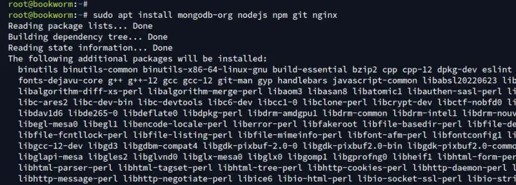

Now update your Debian package index and install MongoDB, Node.js, NPM, Nginx, and Git. Input Y to confirm the installation.
sudo apt install mongodb-org nodejs npm git nginx

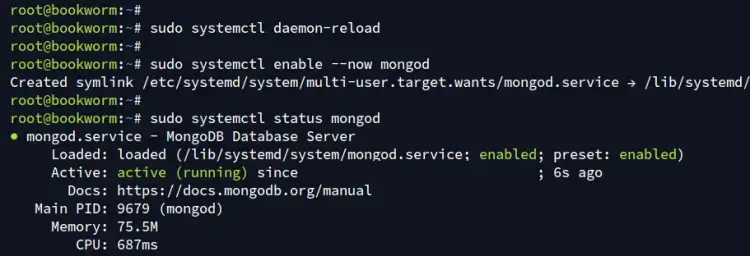

Now run the command below to start, enable, and verify the MongoDB service status.
sudo systemctl enable --now mongod
sudo systemctl status mongod
The following output confirms that MongoDB is running.

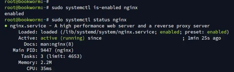

Next, check the Nginx service status with the command below. You should see Nginx is enabled and running on your system.
sudo systemctl is-enabled nginx
sudo systemctl status nginx

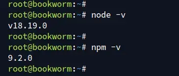

Lastly, check the Node.js and NPM version with the following:
sudo node-v
sudo npm -v
You can see below that Node.js 18 and NPM 9 are installed.

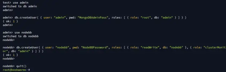

Run the following query to switch to the ‘admin’ database and create a new administrator user ‘admin‘ for MongoDB. Make sure to change the password ‘MongoDBAdminPass‘ with the new password.
use admin
db.createUser( { user: "admin", pwd: "MongoDBAdminPass", roles: [ { role: "root", db: "admin" } ] } )
Next, create a new database and user ‘nodebb‘ with the password ‘NodeBBPassword‘. This database and user will be used for the NodeBB installation.
use nodebb
db.createUser( { user: "nodebb", pwd: "NodeBBPassword", roles: [ { role: "readWrite", db: "nodebb" }, { role: "clusterMonitor", db: "admin" } ] } )
Now type ‘quit()‘ to exit from the MongoDB.

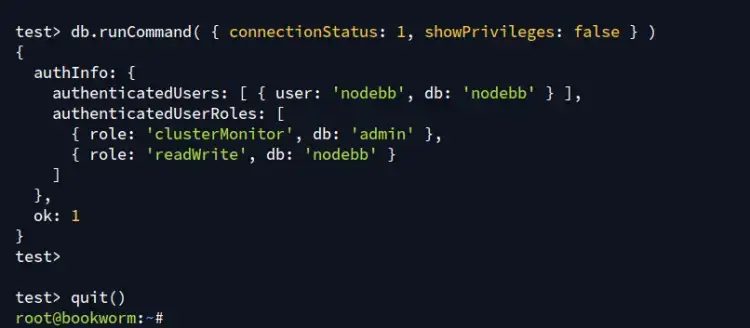

To ensure that your MongoDB configuration is successful, log in to the MongoDB with the user ‘nodebb‘ to the database ‘nodebb‘. Enter your password when asked.
mongosh "mongodb://127.0.0.1:27017" --username nodebb --authenticationDatabase nodebb
After logging in, run the query below to check your connection and exit from the MongoDB.
db.runCommand( { connectionStatus: 1, showPrivileges: false } )
quit()
In the following output, you can see the authenticated as ‘nodebb‘ to the database ‘nodebb‘.

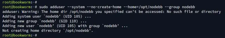

Add a new system user ‘nodebb‘ with default home directory ‘/opt/nodebb‘ using the following command.
sudo adduser --system --no-create-home --home=/opt/nodebb --group nodebb

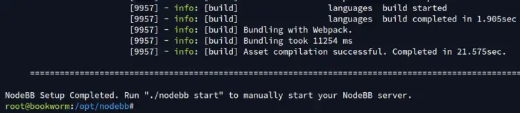

Go to the ‘/opt/nodebb’ directory and configure your NodeBB installation with the command below.
cd /opt/nodebb
sudo su -s /bin/bash -c "./nodebb setup" nodebb
  • Input your domain name for NodeBB.
  • Leave the NodeBB secret as default and press ENTER.
  • Type no to disable anonymous plugin usage.
  • Select the database as MongoDB.
  • Input the MongoDB database with url string: mongodb://nodebb:[email protected]:27017/nodebb.
  • Input your administrator user and email address for NodeBB.
  • Input your password and repeat.
After the process is complete, you will see an output ‘NodeBB Setup Completed‘. You can also see the command to run NodeBB.

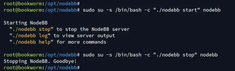

Next, execute the command below to start or stop NodeBB. You can use this when you need to start to stop NodeBB manually.
sudo su -s /bin/bash -c "./nodebb start" nodebb
sudo su -s /bin/bash -c "./nodebb stop" nodebb

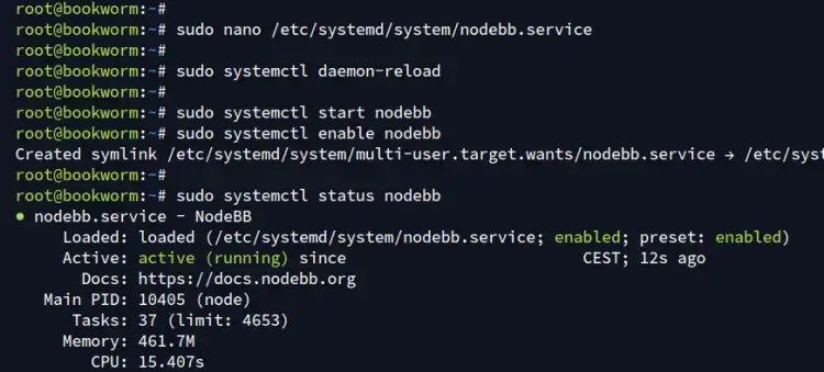

After that, start and enable the ‘nodebb‘ service with the following systemctl command.
sudo systemctl start nodebb
sudo systemctl enable nodebb
Verify the ‘nodebb‘ service with the following to ensure that the service is running.
sudo systemctl status nodebb
You can see below the NodeBB is running in the background as a systemd service.

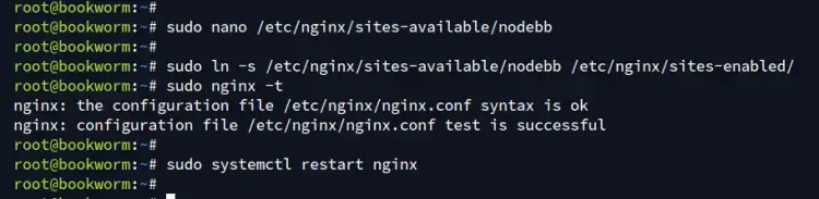

Now activate the server block file ‘nodebb’ and test your Nginx syntax with the following:
sudo ln -s /etc/nginx/sites-available/nodebb /etc/nginx/sites-enabled/
sudo nginx -t
If you have proper Nginx syntax, you will see an output ‘syntax is ok – test is successful’.
Lastly, run the command below to restart the Nginx service and apply your changes.
sudo systemctl restart nginx

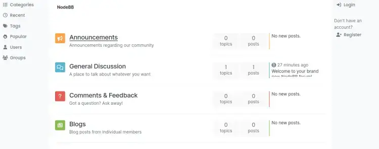

Visit https://forum.howtoforge.local/ using your web browser and you will see the default index page of NodeBB like the following:

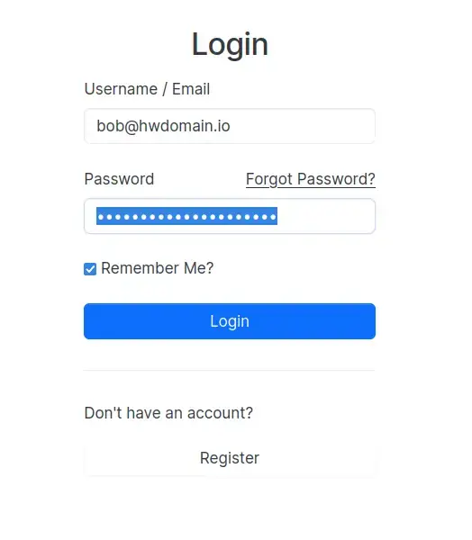

From the home page, click the Login menu and you will be shown the NodeBB login page. Enter your admin user and password, and then click Login.

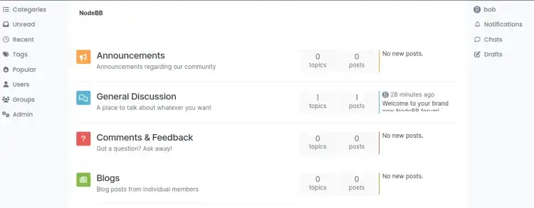

If successful, you will see the following user dashboard.

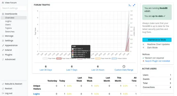

Click on the Admin menu to access the NodeBB administration dashboard like the following:
Congratulations! You have now installed NodeBB on the Debian 12 server. You have NodeBB running with the MongoDB database and Nginx reverse proxy. You also secured NodeBB with HTTPS through Certbot and Letsencrypt.
