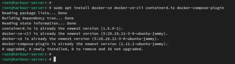

Next, use the following apt command to install Docker CE and Docker Compose to your system.
sudo apt install docker-ce docker-ce-cli containerd.io docker-compose-plugin
Input y to confirm the installation, then press ENTER to proceed.

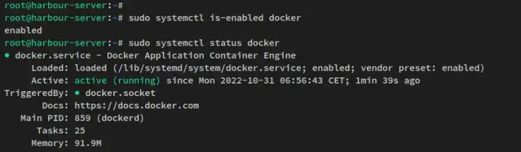

After Docker is installed, run the following systemctl command to verify the current status of the Docker service.Ezoic
sudo systemctl is-enabled docker
sudo systemctl status docker
You should now receive the output like the following screenshot – the Docker service is running and enabled. The Docker service will be run automatically at system boot.

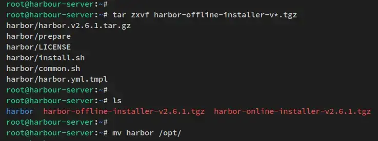

Now extract the harbor offline installer via the tar command below. After the installer is extracted, you should see the new directory ‘harbor‘.
tar -xzvf harbor-offline-installer-v2.6.1.tgz
Move the ‘harbor‘ directory to ‘/opt’, which means your harbor installation will be ‘/opt/harbor’.
sudo mv harbor /opt/

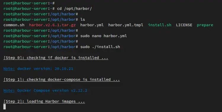

Now run the harbor installer script ‘install.sh‘ with sudo privileges.
sudo ./install.sh
The installer script will now check the system requirements before starting the harbor installation. The installer will ensure that the Docker engine and Docker Compose are installed on the system.

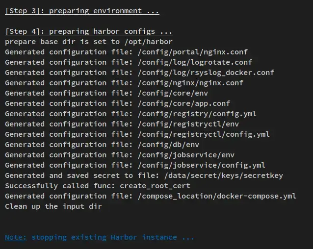

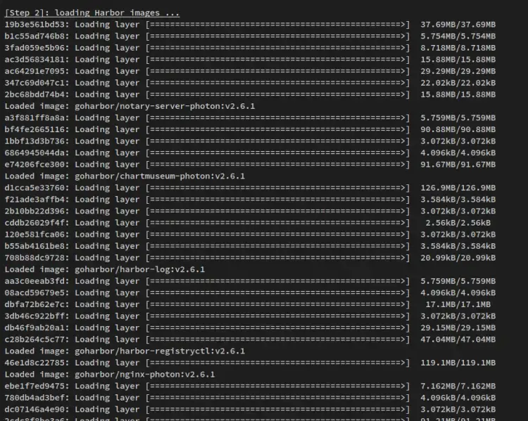

Now the installer will extract images that will be used to deploy harbor.
After that, the installer will be preparing the system environment for the harbor deployment and generate the necessary configurations. Then, the installation will begin.

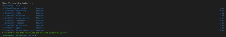

When installation finished, you should see the output of harbor container services is running.

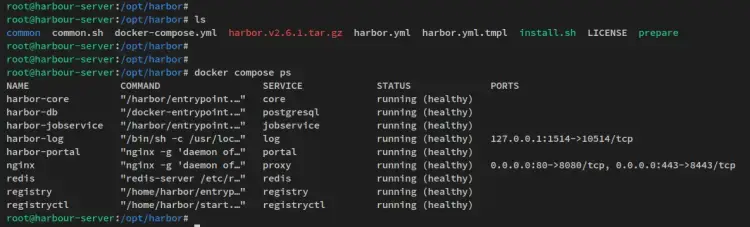

Run the following ‘docker compose’ command to verify that the harbor container services are running.
ls
docker compose ps
In the below output – the harbor container services are running and healthy.

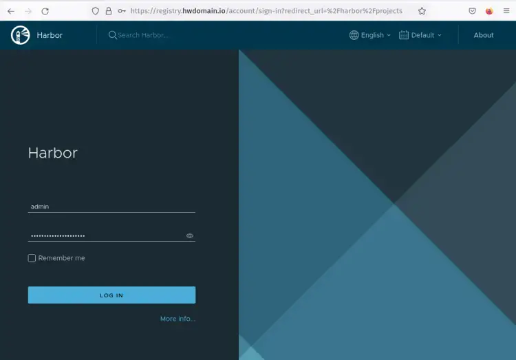

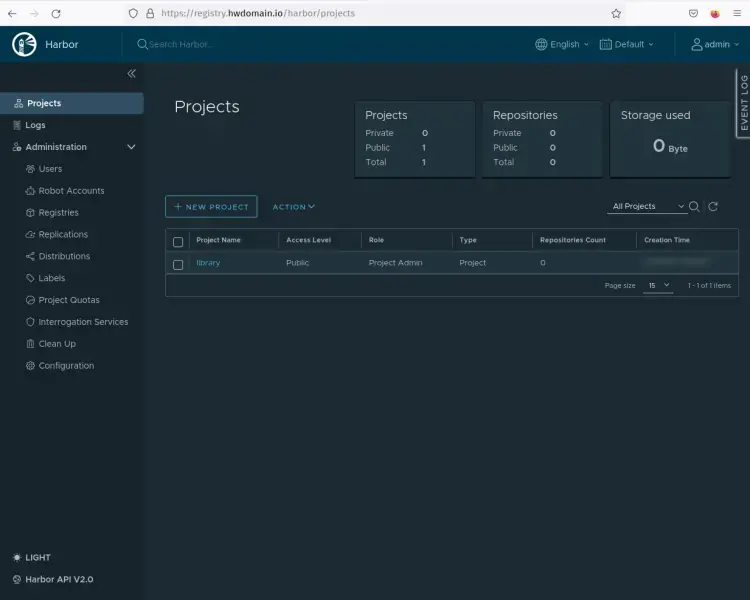

Next, open your web browser and visit the domain name for your harbor installation (i.e: https://registry.howtoforge.local/). And you should now get the login page of your harbor image registry.
Login with the default user admin and the password that you have configured via the configuration file ‘harbor.yml‘.
You should now get the harbor dashboard when you have the correct password.  Also, you can see on your screen the default project in the harbor with the name ‘library‘.

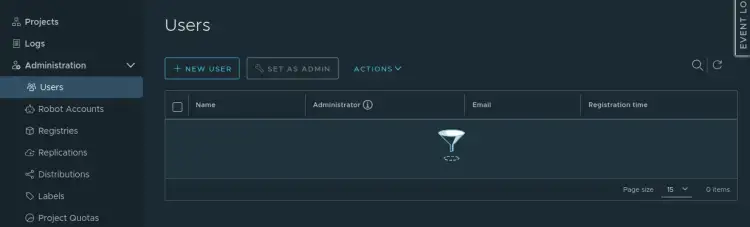

Creating Harbor User
After the harbor image registry is running, you should now learn how to set up and create a new user via the harbor administration dashboard.

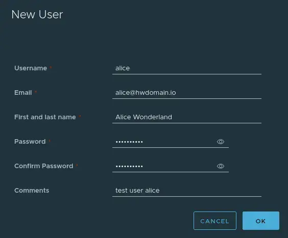

In the ‘Administration‘ section, click the menu ‘Users‘, then click the ‘NEW USER‘ button.
Input details about the new user and confirm by pressing the ‘OK‘ button. In this example, you will create a new harbor user ‘alice‘ that will be used to log in to the harbor via the docker cli.

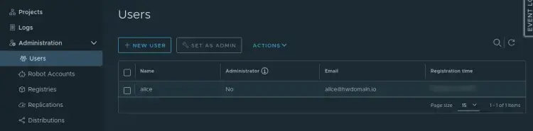

Once the user is created, you should see your user on the ‘User’s menu list.

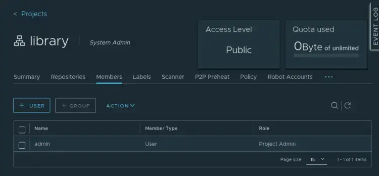

Adding User to Harbor Project
In harbor, the user space that the user will be working on is the project. On the default installation, harbor provides the default project name ‘library‘.
In this step, you will learn how to add the new user ‘alice‘ to the default project ‘library‘ so that the new user will be able to manage the ‘library‘ project. Also, you will need to assign the role for the new user on the target project.

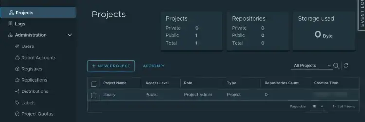

Click on the ‘Project; menu and you should see the default project ‘library‘ available on your harbor.
NClick the project ‘library‘ to get the details settings of that project.

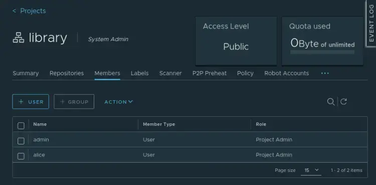

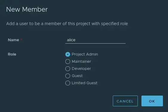

Click the menu ‘Members’ and you should see there is only one member admin on that project. Click ‘the ‘USER‘ button to add the harbor user to the project ‘library‘.
Input the user that you want to add to the project and assign the role to that user. This example will add the user ‘alice‘ to the project ‘library’ with the role ‘Project Admin‘.
Click ‘OK‘ to confirm.
You should now see the user ‘alice‘ is available on the member list of the ‘library‘ project.

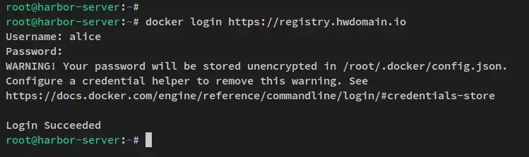

Back to your terminal server and run the following docker command to log in to the harbor image registry.
docker login https://registry.howtoforge.local/
When prompted, input the username and password for your user. This example will be using the user ‘alice‘.
When login success, you should see a message such as ‘Login Succeeded‘.

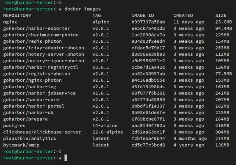

Before you start, run the following docker command to download the latest version of image ‘nginx:alpine’.
docker pull nginx:alpine
Now verify the list of images via the docker command below. You should see the image ‘nginx:alpine‘ downloaded.
docker images

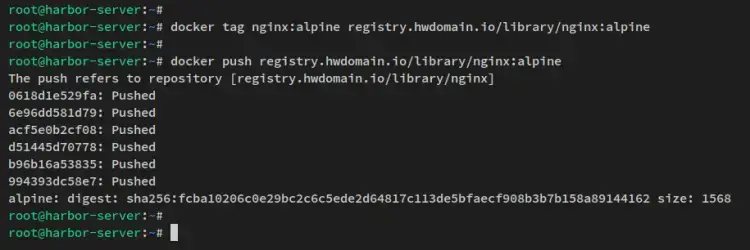

To push the custom images to the harbor image registry, you can change the tag of the current image with the format such as ‘harbor-domain.com/project/image:version‘.
So, run the following command to change the default tag ‘nginx:alpine‘ with the ‘registry.howtoforge.local/library/nginx:alpine‘.
docker tag nginx:alpine registry.howtoforge.local/library/nginx:alpine
After that, upload and push the image to the harbor image registry with the following command. This command will upload the image to the image registry ‘registry.howtoforge.local’ with the project name ‘library‘.
docker push registry.howtoforge.local/library/nginx:alpine
Below is the output during the process of pushing the image to the harbor image registry.

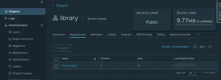

Once the image is uploaded to the harbor, back to the harbor administration dashboard and click the ‘Project‘ menu and click ‘Repositories‘. You should see the new image is uploaded to the harbor image registry via the docker command line.
