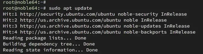

First, update your Ubuntu package index with the following command.

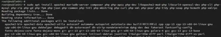

Now install the LAMP Stack (Linux, Apache, MariaDB, and PHP) and Composer dependencies to your Ubuntu system with this:
sudo apt install apache2 mariadb-server composer php php-apcu php-dev libapache2-mod-php libcurl4-openssl-dev php-cli php-mysql php-zip php-gd php-fpm php-json php-common php-intl php-mbstring php-curl php-xml php-pear php-tidy php-uploadprogress php-soap php-bcmath php-xmlrpc
Input Y to confirm the installation.

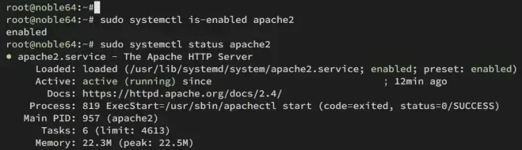

Check the Apache service with the command below. This will ensure that Apache is running and enabled on your server.
sudo systemctl is-enabled apache2
sudo systemctl status apache2
An out enabled indicates that the Apache web server will start at boot. And the active(running) shows that Apache is running.

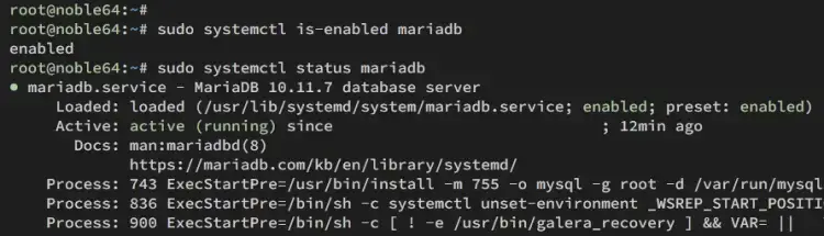

Now check the MariaDB service status with the following:Ezoic
sudo systemctl is-enabled mariadb
sudo systemctl status mariadb
Like Apache, you will see an output enabled and the ‘active(running)’ status, confirming that MariaDB will start at boot and the status is running.

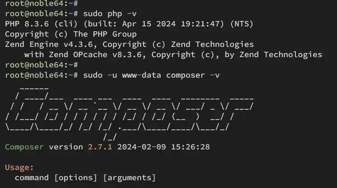

Lastly, check the PHP and Composer versions using the command below. At this time, the default Ubuntu 24.04 repository provides PHP 8.3 and Composer 2.7.1.
sudo php -v
sudo -u www-data composer -v

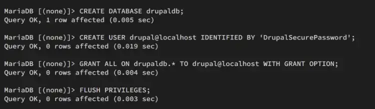

Run the following queries to create a new database and user for Drupal. In this example, you will create a new user ‘drupal‘, database ‘drupaldb‘, with the password ‘DrupalSecurePassword‘. Make sure to change the information with your details.
CREATE DATABASE drupaldb;
CREATE USER drupal@localhost IDENTIFIED BY 'DrupalSecurePassword';
GRANT ALL ON drupaldb.* TO drupal@localhost WITH GRANT OPTION;
FLUSH PRIVILEGES;

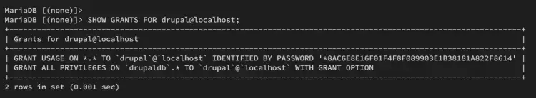

Now run the query below to verify user ‘drupal‘. Ensure that user ‘drupal‘ can access the database ‘drupaldb‘.
SHOW GRANTS FOR drupal@localhost;
The following output indicates that user ‘drupal‘ can access the database ‘drupaldb‘.

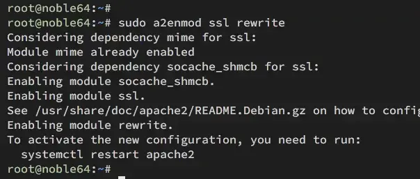

First, run the command below to enable Apache modules ‘ssl‘ and ‘rewrite‘.
sudo a2enmod ssl rewrite

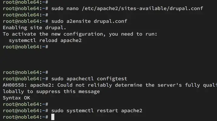

Now run the command below to activate the ‘drupal.conf’ virtual host file, and then verify your Apache syntax. If you have proper Apache syntax, you should get an output ‘Syntax is OK‘.
sudo a2ensite drupal.conf
sudo apachectl configtest
Lastly, restart Apache with the following to apply your new virtual host configuration. With this, your Drupal should be accessible.

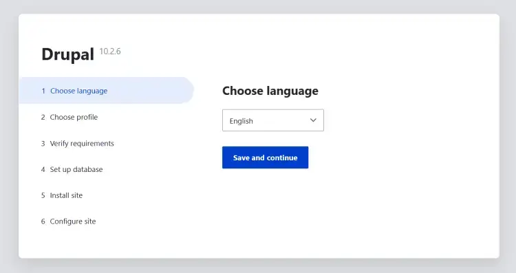

Visit your Drupal domain name, such as https://hwdomain.io from your preferred web browser. If your installation is successful, you should get the Drupal installation wizard.
Select the default language for Drupal, and then click Save and continue.

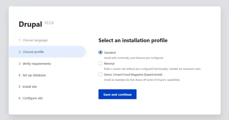

Select your preferred Drupal installation profile click Save and continue. For beginners, use the Standard or Demo profile. If you’re experienced with Drupal, you can select Minimal profile.

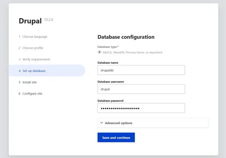

If ready, you will be redirected to the database configuration for Drupal. Input your MariaDB server details, database name, username, and password, and then click Save and continue.

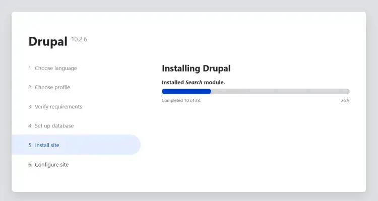

The Drupal installation should begin:

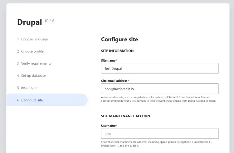

After the Drupal installation is complete, you must configure your Drupal site. Input the Site name, email address, administrator username, password, default country, and time zone.
Click Save and continue to confirm.

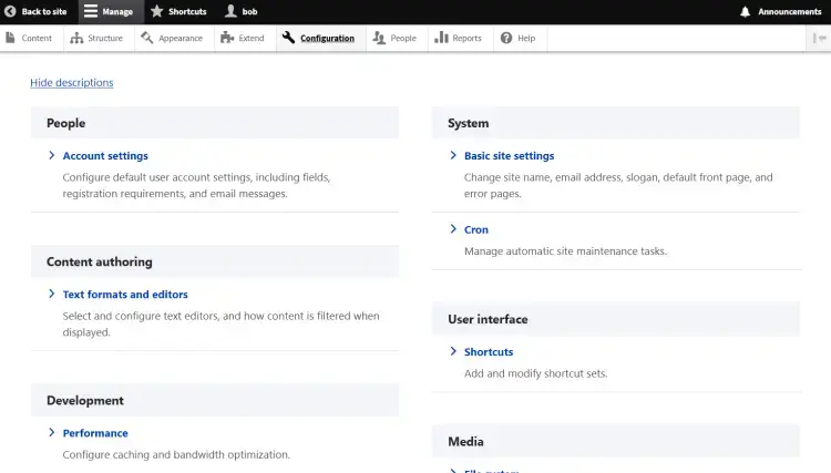

Here, click the Manage > Configuration menu to access the Drupal administration dashboard. You will see the following:
