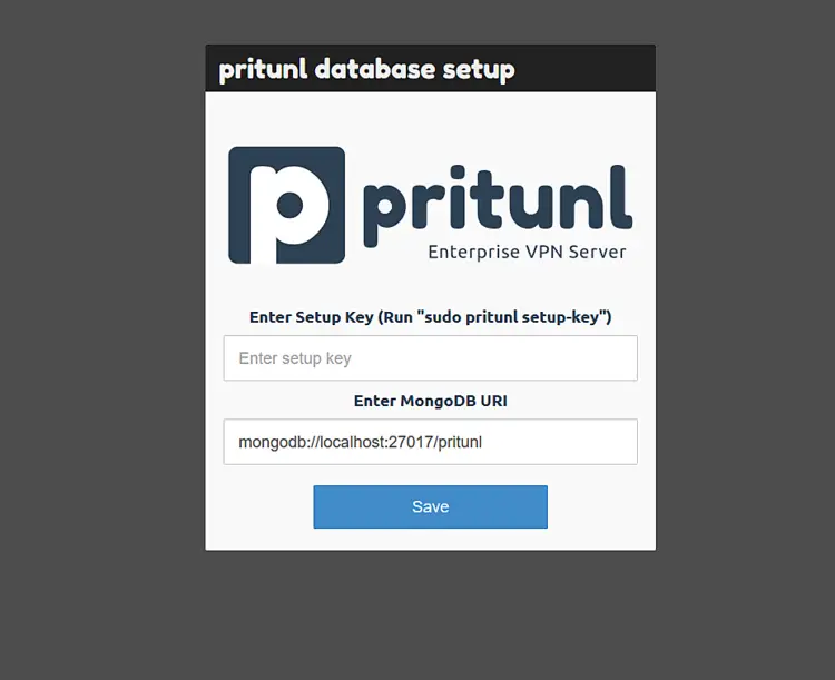

You will be greeted by the following screen when you first launch Pritunl on browser.
You need a setup key here. To generate your setup key, run the following command.
$ sudo pritunl setup-key

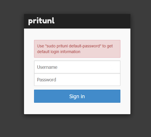

Paste the key that is generated in the box and press Save. You will be greeted by the following screen.
As per the instruction given, run the following command to get your login credentials.
$ sudo pritunl default-password

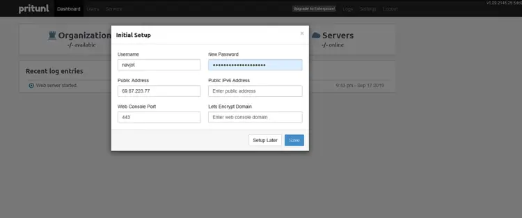

Sign in to proceed to the Initial Setup screen. Enter the domain you have registered for your VPN site in the Lets Encrypt domain text field. If you want to change your password, you can enter a new password. You can also change your username here. Press Save to continue.

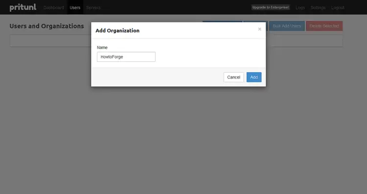

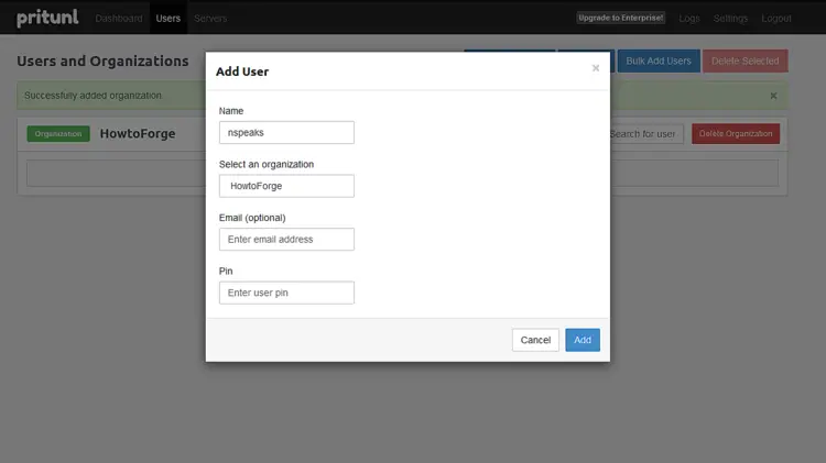

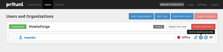

Go to the Users tab. To connect to the VPN, you would need to create an organization and a user. Click on Add Organization first. Once you have created that, Add a user to that organization by clicking on Add User.

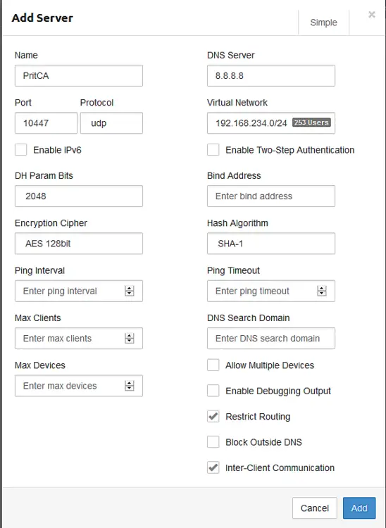

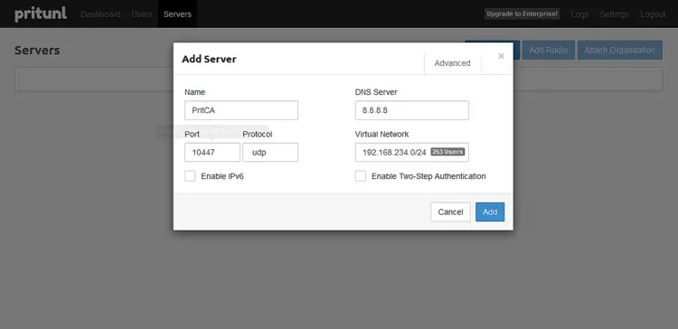

It is time to create a server to which your users can connect. Go to the Servers tab and click on Add a Server.
Choose a name for your server. Select the Protocol as UDP and the Port as 10447 which we added earlier to our firewall. You can, of course, use whatever port you had added to your firewall.
If you want to control how many clients and how many devices can connect to your server, you can configure that by clicking the Advanced button. Here’s how it will look. Make sure Allow multiple devices is selected first.
Click Add to proceed.

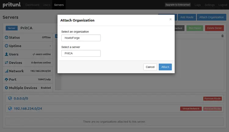

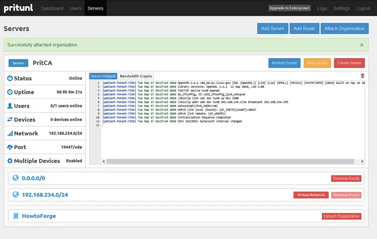

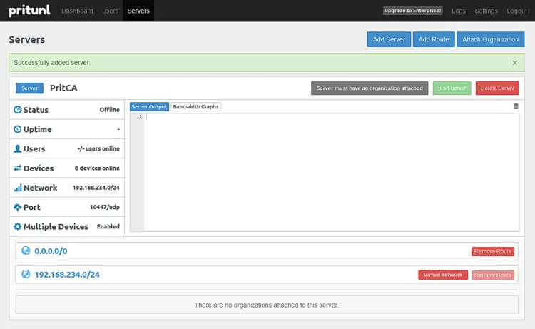

The next step is to attach the server we just created to our Organization. Click Attach Organization to do that.
Once that is done, click on Start Server to start your VPN service.
You have completed the configuration of your Pritunl VPN server.

To connect via OpenVPN client, you will need the configuration file for it. Switch to the Users tab and click on the Download button.
You can extract the configuration file and import it into your OpenVPN client to connect. To confirm whether you are connected successfully via the VPN, one of the ways is to visit whatismyip.com. It will show your changed IP and location if your connection is successful.
