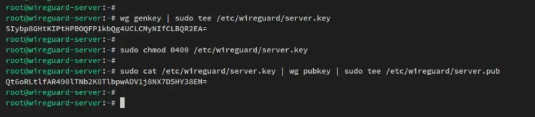

Run the below ‘wg genkey‘ command to generate the private key for the Wireguard server. Then, change the permission of the private key to ‘0400‘, which will disable read and write access for the group and others.
In this example, you’ll generate the private key ‘/etc/wireguard/server.key’.
wg genkey | sudo tee /etc/wireguard/server.key
sudo chmod 0400 /etc/wireguard/server.key
You’ll then receive an output random base64 key on your terminal screen.
Next, run the below command ‘wg pubkey‘ to generate the new server public key to ‘/etc/wireguard/server.pub‘. The server public key is derived from the server private key ‘/etc/wireguard/server.key‘.
sudo cat /etc/wireguard/server.key | wg pubkey | sudo tee /etc/wireguard/server.pub
You’ll then receive an output of a random base64 public key on your terminal.
Now that you have generated public and private key pairs for the Wireguard server. The private key is located at ‘/etc/wireguard/server.key’, and the public key is located at ‘/etc/wireguard/server.pub‘.

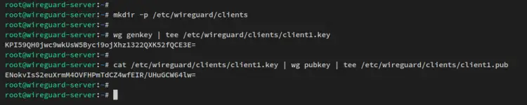

Run the below ‘wg genkey’ command to generate the client private key to ‘/etc/wireguard/clients/client1.key‘. Then, generate the client public key via the ‘wg pubkey‘ command to ‘/etc/wireguard/clients/client1.pub‘.
wg genkey | tee /etc/wireguard/clients/client1.key
cat /etc/wireguard/clients/client1.key | wg pubkey | tee /etc/wireguard/clients/client1.pub

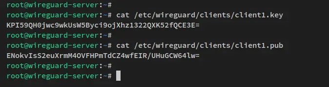

Now that the client keypair is generated, the public key is located at ‘/etc/wireguard/clients/client1.pub’ and the private key is ‘/etc/wireguard/clients/client1.key‘. Run the below command to show and verify the generated keypair.
cat /etc/wireguard/clients/client1.pub

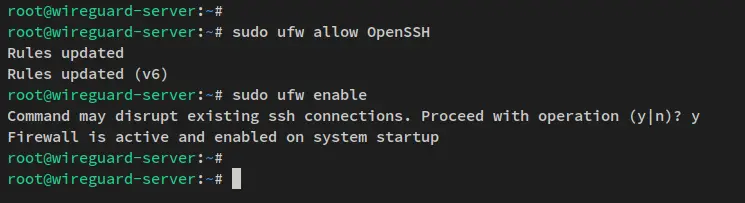

After ufw is installed, run the below command to open the SSH service and enable the ufw firewall.
sudo ufw allow OpenSSH
sudo ufw enable
When prompted for confirmation to enable the ufw firewall, input y and press ENTER. The ufw firewall should now be running on your system and it’s also enabled.
Now verify the ufw firewall status via the below command. You should receive an output such as ‘Status: active‘, which means the ufw firewall status is running.
sudo ufw status

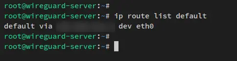

Now run the below command to check the default routing table interface on the Wireguard server. Mostly, this will detect an interface that is used for accessing the internet or where the public IP address is available on top of it.
ip route list default
You’ll receive an output like this – This example is the interface eth0 is the default routing table for the Wireguard server. And this is the interface that is used for accessing the Internet. You may have a different interface name.

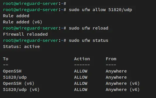

Now run the below ufw command to open the UDP port 51820 where clients will be connected.
sudo ufw allow 51820/udp
Lastly, run the below command to reload the ufw firewall and apply the changes. Then, verify the list of ufw rules via the below command.
sudo ufw reload
sudo ufw status
You’ll receive an output like this screenshot – The UDP port 51820 that the Wireguard server will use for client connections added to the ufw firewall.

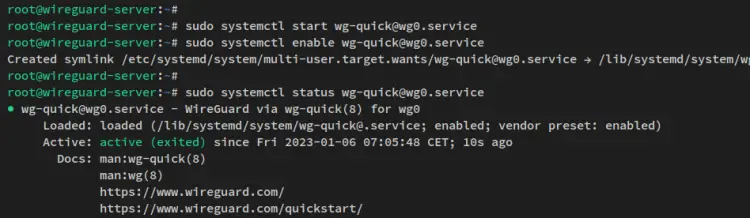

Run the below systemctl command utility to start and enable the Wireguard service. The service ‘[email protected]‘ will create and enable the Wireguard interface ‘wg0‘ on your Wireguard server.
sudo systemctl start [email protected]
sudo systemctl enable [email protected]

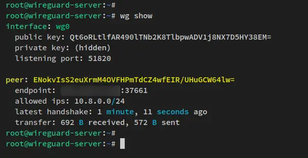

Now verify the Wireguard service via the below command.
sudo systemctl status [email protected]
You will receive an output similar to the following screenshot – The Wireguard service ‘[email protected]‘ is running and it’s enabled. This also means that the ‘wg0‘ interface is created and running.

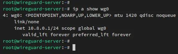

Run the below command to verify the ‘wg0’ interface on your Wireguard server.
ip a show wg0
You should receive an output like this – The Wireguard interface wg0 gets an IP address ‘10.8.0.1‘, as described on the Wireguard config file ‘/etc/wireguard/wg0.conf‘.

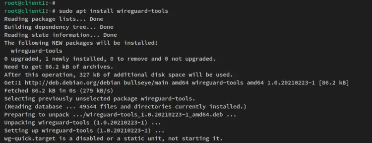

Install the ‘wireguard-tools‘ package on the client machine. This uses a Debian as the client, so the APT command will be used.
sudo apt install wireguard-tools
The installation should automatically begin.

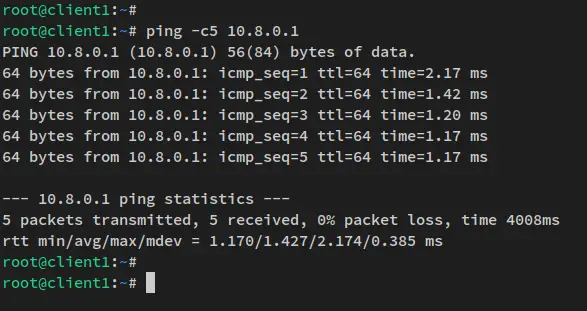

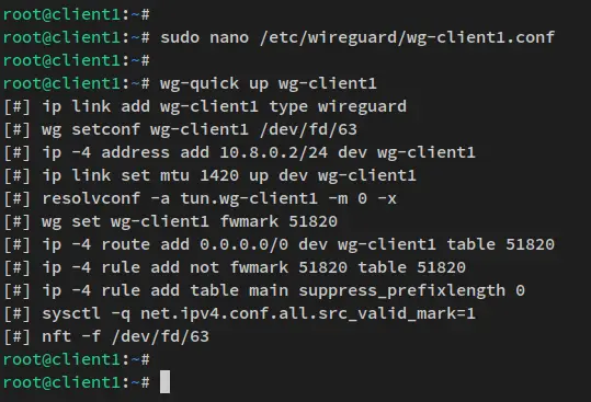

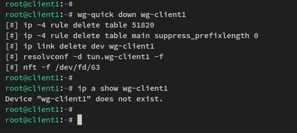

After the client configuration is created, run the below command to start Wireguard on the client machine.
wg-quick up wg-client1
You should receive an output similar to this screenshot – The new Wireguard interface ‘wg-client1‘ will be created and the client machine should be connected to the Wireguard server that running on ‘SERVER-IP:51820‘.

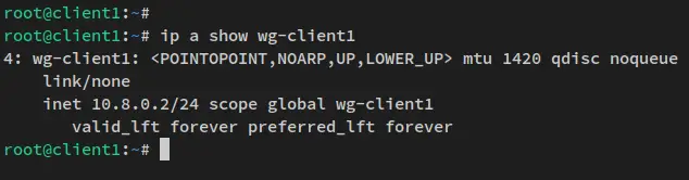

Run the below command to verify the Wireguard interface ‘wg-client1‘.
ip a show wg-client1
You should receive an output like this – The wg-client1 interface is up with an IP address ‘10.8.0.2‘, which is part of the subnet of Wireguard server ‘10.8.0.0/24′.

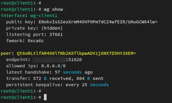

You can also verify the Wireguard connection via the ‘wg show‘ command.
Run the below ‘wg show’ command on the client machine and you should receive an output like this.
wg show
If you’re connected to the proper Wireguard server, you should see the Wirguard server IP address on the ‘endpoint‘ section and see the Wirguard server public key ‘server.pub‘.
Now move to the Wireguard server and run the ‘wg show‘ command.
wg show
You should receive an output similar to this – On the endpoint section, you’ll see the client’s public IP address, and on the peer section, you’ll see the client public key ‘client1.pub‘.

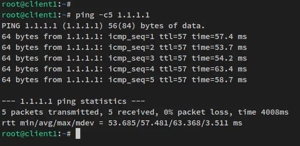

Lastly, run the below command to ensure that the client machine can access the internet or access the internal network subnet of the Wireguard VPN.
ping -c5 10.8.0.1
ping -c5 1.1.1.1
ping -c5 duckduckgo.com
Below is the output you should receive:
The client machine can connect to the Wireguard server with an IP address ‘10.8.0.1‘.
The client machine can access the internet. All traffic is routed via the Wireguard server’s public IP address.
Now if you want to stop the Wrieguard on the client machine, you can run the ‘wg-quick down‘ command below
wg-quick down wg-client1
You’ll recieve the outpuit like this. Also, the interface wg-client1 will be disspear from the client machine.
Now you’ve configured the Wirguard VPN on the client machine. You’ve also verified the connection between the client machine to the Wireguard server.
