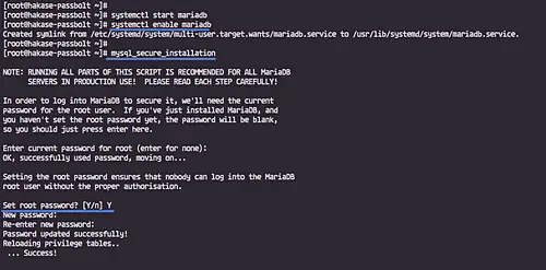

After the installation is complete, start the MariaDB service and enable it to launch everytime at system boot time.
sudo systemctl start mariadb
sudo systemctl enable mariadb
Now we need to configure the ‘root’ password for MariaDB. Run the ‘mysql_secure_installation’ command below.
Type your new root password.
And the MariaDB root password configured.

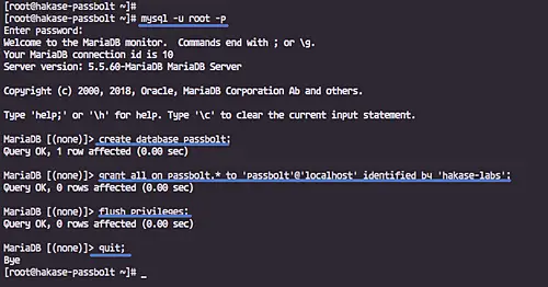

Next, login to the MySQL shell using the ‘root’ user.
mysql -u root -p
Create a new database and user named ‘passbolt’ with password ‘hakase-labs’, run MySQL queries below.
create database passbolt;
grant all on passbolt.* to 'passbolt'@'localhost' identified by 'hakase-labs';
flush privileges;
quit;
The MariaDB server has been installed on CentOS 7 server, and the database for ‘Passbolt’ installation created.

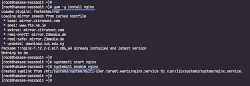

Step 3 – Install Nginx and PHP-FPM
After installing the MariaDB server, we will install Nginx from the EPEL repository, and PHP-FPM packages using the Remi repository.
Install Nginx web server.
sudo yum -y install nginx
After the installation is complete, start the Nginx service and enable it to launch everytime at system boot.
sudo systemctl start nginx
sudo systemctl enable nginx

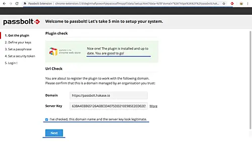

Open your web browser and install the ‘Passbolt’ extensions of your web browser.
Following is the link of passbolt extension for Chrome browser. Install the extension.
https://chrome.google.com/webstore/detail/passbolt-extension
Now open a new tab and paste the ‘registration’ link given to the address bar. Mine was:
https://passbolt.hakase.io/setup/install/b830cc87-1aa5-4f6f-95f4-9be21accdefa/103001a4-39a1-4bb9-866c-822ac0f7c76f
And you will a page similar to the one shown below.

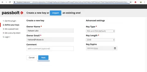

Check the box on the bottom and click the ‘Next’ button. Now you will be asked for creating a new key for the user.
Click ‘Next’ button.

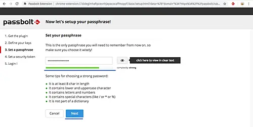

Setup the ‘Passphrase’, type your strong passphrase.

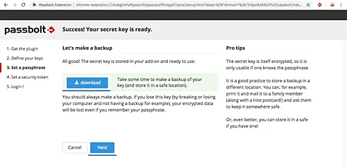

Click ‘Next’ button. Backup your key by pressing the ‘Download’ button and click ‘Next’ again.

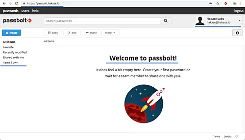

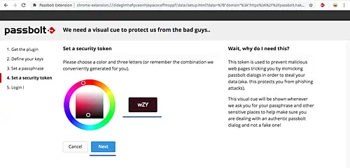

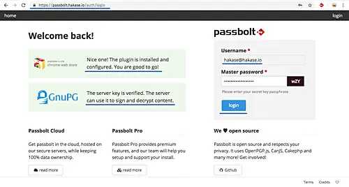

For the security token, leave it default and click ‘Next’.
And you will be redirected to the Passbolt login page.
Type your ‘Passphrase’ and click ‘Login’. And you will see the Passbolt user Dashboard as below.
Passbolt open source password manager installation on CentOS 7 has been completed successfully.
