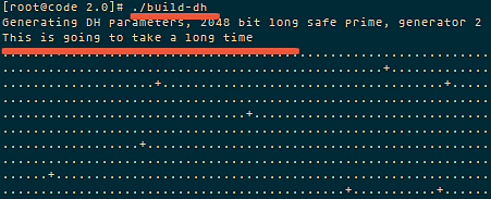

Step 3 – Build a Diffie-Hellman key exchange.
Execute the build-dh command:
./build-dh
please wait, it will take some time to generate the the files. The time depends on the KEY_SIZE you have the settings on the file vars.
