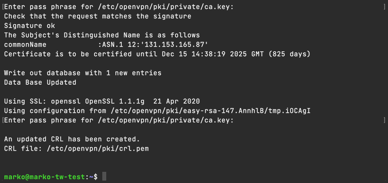

Step 5: Generate Client Certificate
A client certificate allows a client machine to connect to the OpenVPN server. Generate the certificate with the command below, replacing [client-name] with the name of the client that connects to the server:
docker run -v $OVPN_DATA:/etc/openvpn --log-driver=none --rm -it kylemanna/openvpn easyrsa build-client-full [client-name] nopass
Type the CA passphrase when prompted and wait for the certificate generation to complete.

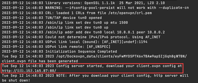

1. Run the container based on the DockOvpn image with this command:
docker run -it --rm --cap-add=NET_ADMIN -p 1194:1194/udp -p 80:8080/tcp -e HOST_ADDR=$(curl -s https://api.ipify.org) --name dockovpn alekslitvinenk/openvpn
Wait for the process to complete. When DockOvpn generates the client configuration file, a message instructs the user to download the file.
2. Go to the address printed in the output on your internet browser. The download will start automatically. Alternatively, use the following curl command:
curl http://[ip-address]:80 --output client.ovpn
3. Use the configuration file in a VPN client to connect to your installed OpenVPN server.
