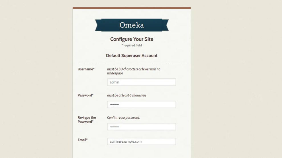

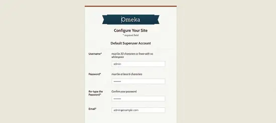

Open your web browser and type the URL http://example.com. You will be redirected to the following page:

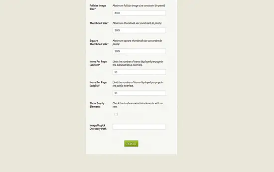

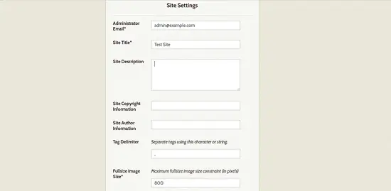

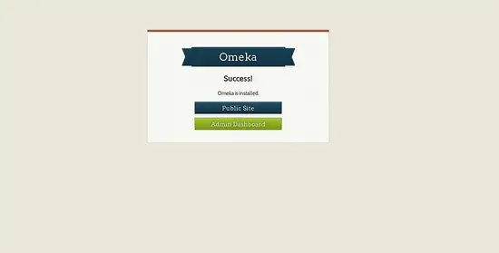

Here, provide all the required details like your admin username and password, site name, email address, then click on the Install button. Once the installation has been completed. You should see the following page:

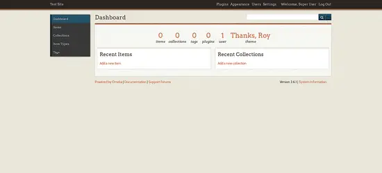

Now, click on the Admin Dashboard button. You should see the following page:

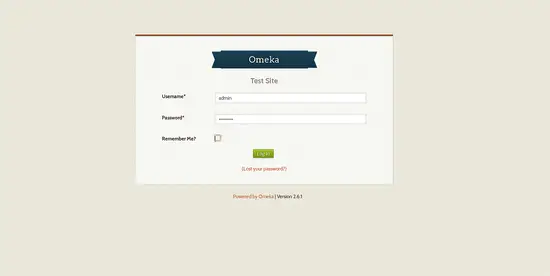

Here, provide your admin login credentials, then click on the Log In button. You should see the following page:
