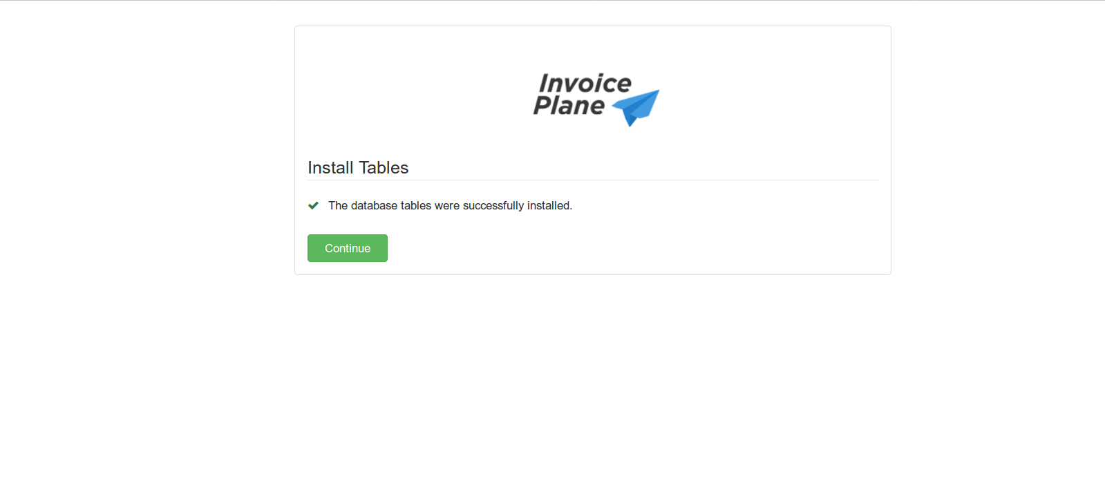

Now, click on the Continue button. You should see the following page:
