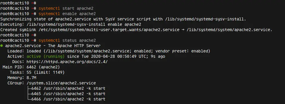

Once all installation is completed, start the Apache2 service and add it to the system boot.
systemctl start apache2
systemctl enable apache2
The Apache2 web server is up and running, check it using the systemctl command below.
systemctl status apache2
Install Apache Webserver
As a result, the installation of the Apache2 webserver is completed.

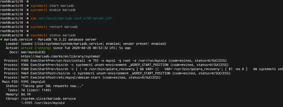

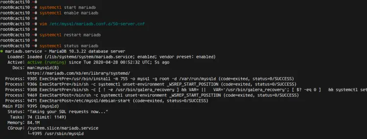

Now restart the MariaDB service and make sure there is no error, then check the MariaDB service status.
systemctl restart mariadb
systemctl status mariadb
Below is the result you will get.
Setup MariaDB for Cacti
As a result, the installation and configuration of MariaDB Server for the Cacti installation has been completed successfully.

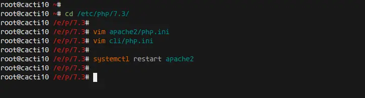

Once all installation is completed, go to the ‘/etc/php/7.3’ directory.
cd /etc/php/7.3/
Edit the ‘php.ini’ configuration for both Apache2 and cli.
vim apache2/php.ini
vim cli/php.ini
Uncomment the ‘date.timezone’ option and change the value with your timezone.
date.timezone = Asia/Singapore
Now uncomment the ‘cgi.fix_pathinfo’ option and change thge value to ‘0’.
cgi.fix_pathinfo = 0
Save and close.
Next, restart the Apache2 service to apply the new configuration.
systemctl restart apache2

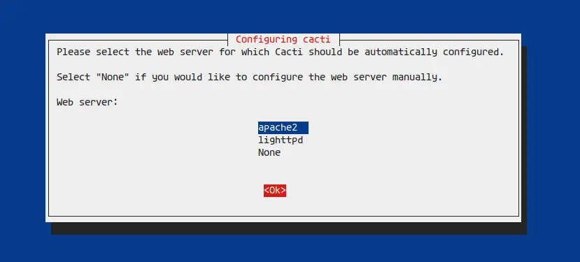

During the installation, you will be asked for the webserver and dbconfig-common configuration.
For the web server configuration, choose the ‘apache2‘ and select ‘OK‘.
Setup Apache for Cacti

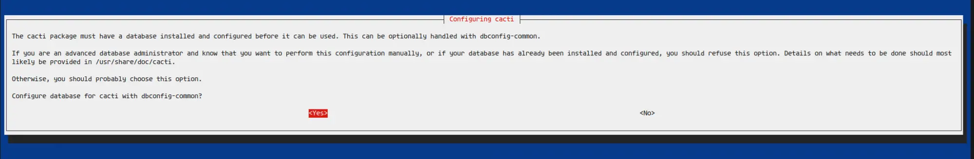

Next, you will be asked for the database configuration through the ‘dbconfig-common’, choose ‘Yes‘ to continue.
Setup Cacti with dbconfig-common

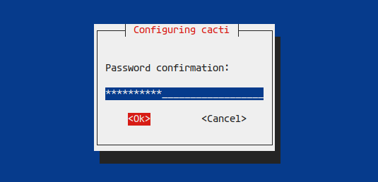

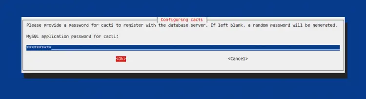

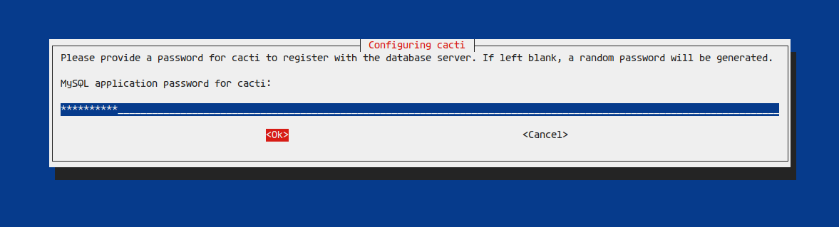

Now type your password for the cacti database configuration and the cacti admin login.
setup cacti admin and database password
Repeat the password and choose ‘OK‘.

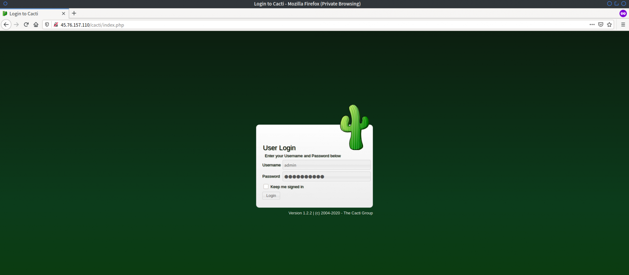

Open your web browser and type the server IP address with the path ‘cacti’ on the address bar.
http://serverip/cacti/

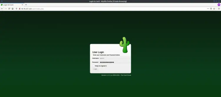

Now you will get the Cacti login page as below.
Cacti login admin
Type the default user ‘admin’ with the password that you just configured and click the ‘Login‘ button.

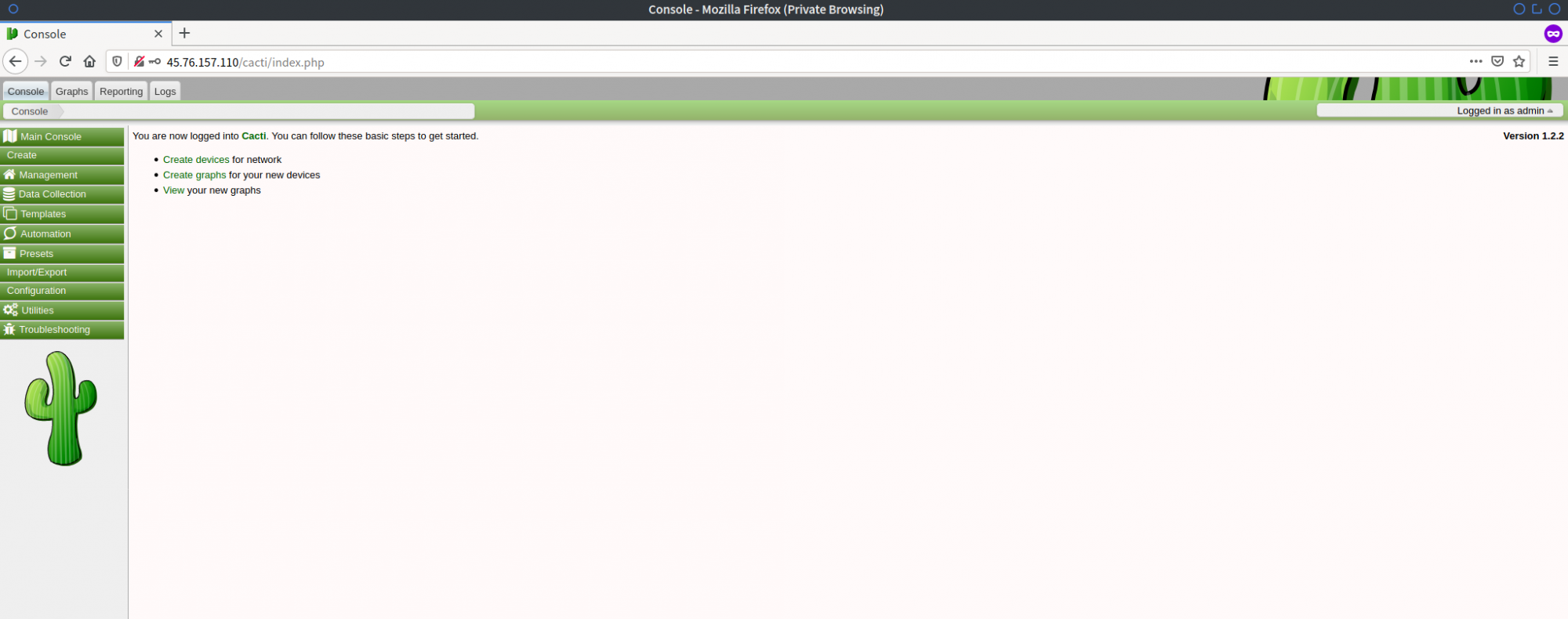

Now you will get the Cacti Admin Dashboard as below.
As a result, the installation and configuration of the Cacti Monitoring Tool with the LAMP Stack on the Debian Buster 10 has been completed successfully.
