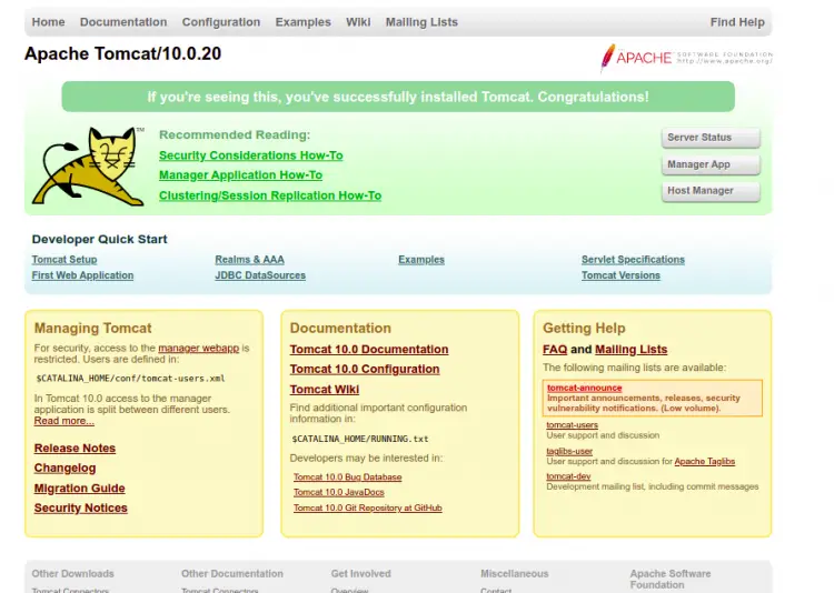

Now, open your web browser and access the Apache Tomcat web interface using the URL http://tomcat.example.com. You should see the Tomcat dashboard on the following screen:

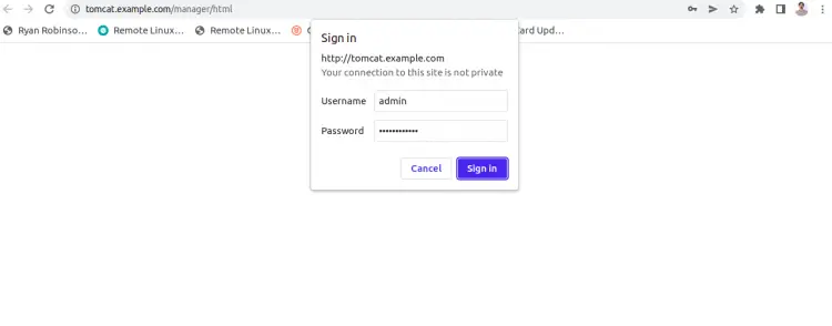

Click on the Manager App. You will be asked to authenticate as shown below:

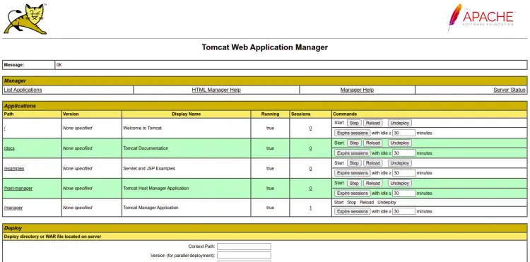

Provide your admin username, and password, and click on the Sign in button. You should see the Manager App dashboard on the following screen:

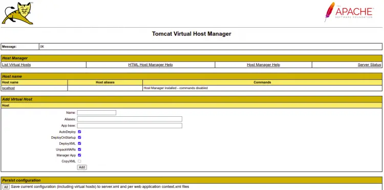

To access the Host Manager app, click on the Host Manager. You should see the following screen:

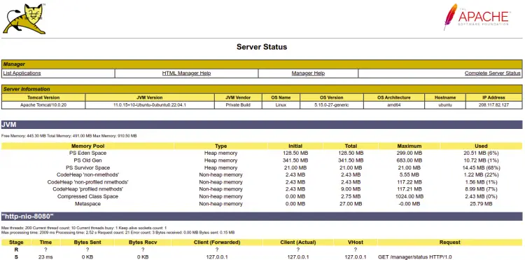

Click on the Server Status. You should see the Apache Tomcat status on the following screen:
