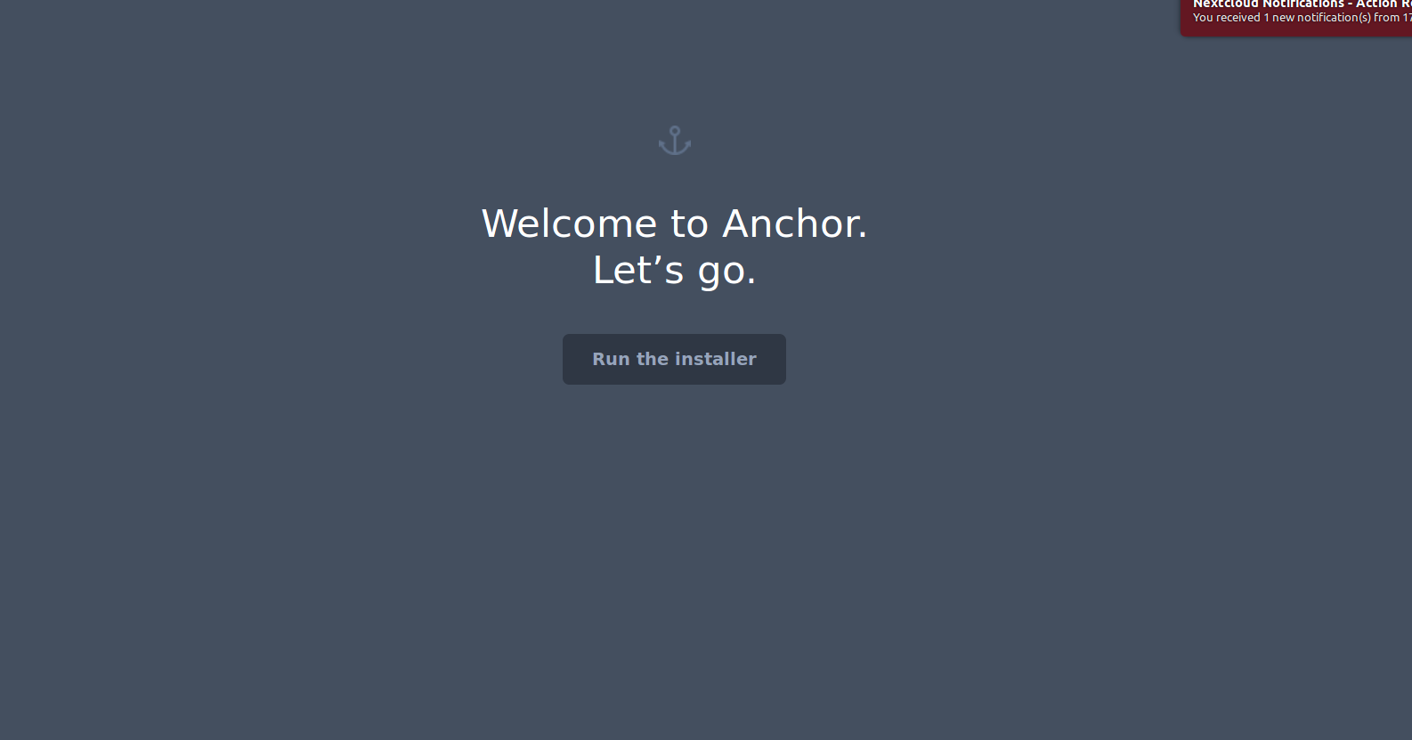

Now, open your web browser and type the URL http://example.com. You will be redirected to the following page:
Now, click on the Run the installer button. You should see the following page:

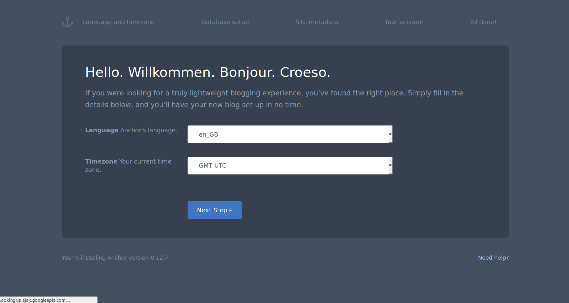

Here, choose Language and Time zone, then click on the Next Step button. You should see the following page:

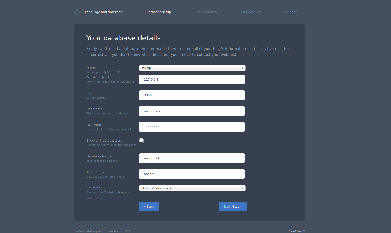

Provide your database details, then click on the Next Step button. You should see the following page:

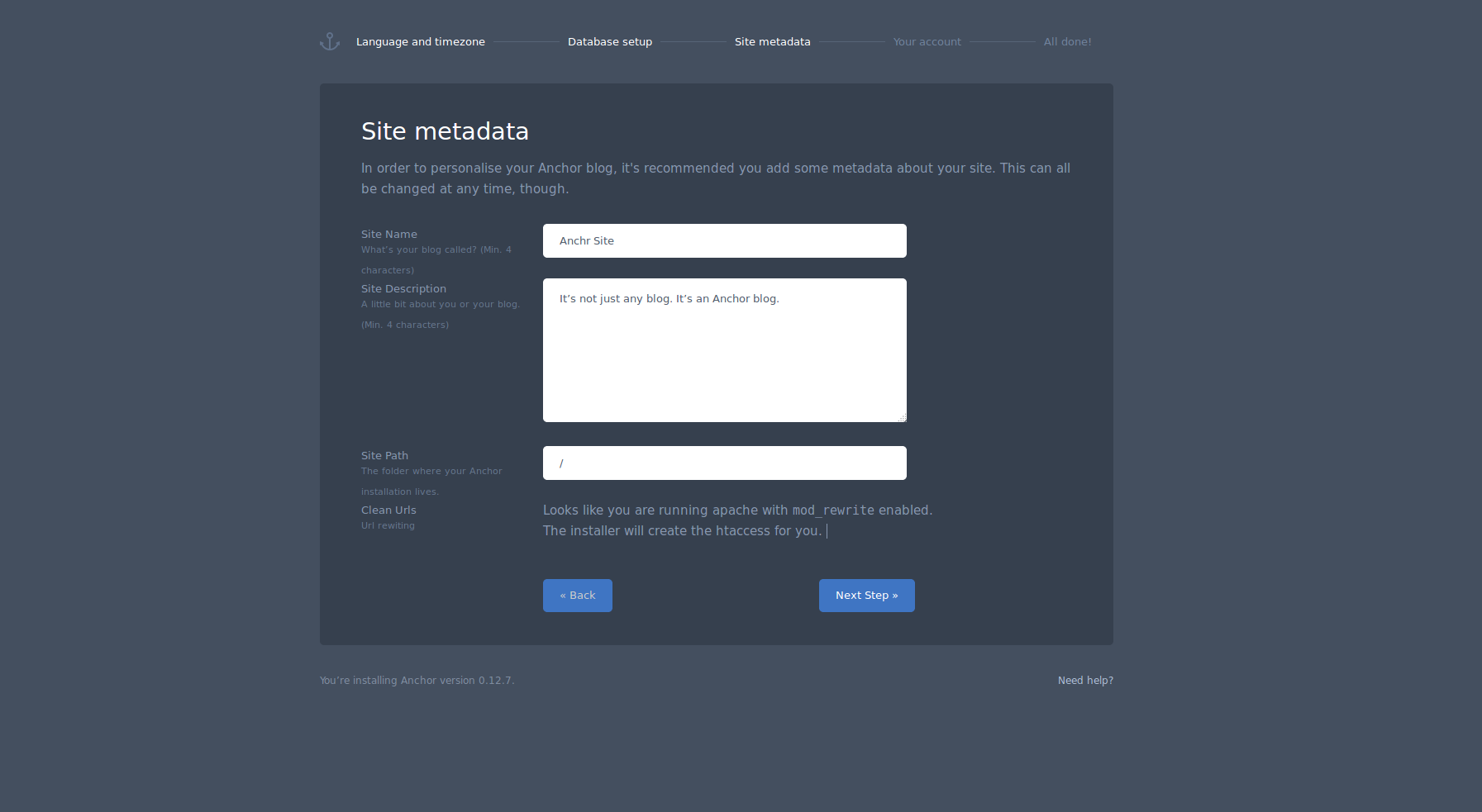

Provide your site name and description, then click on the Next Step button. You should see the following page:

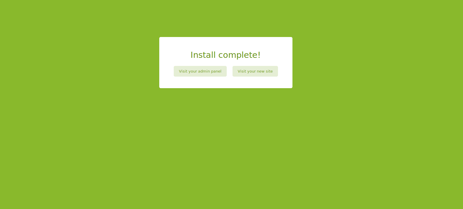

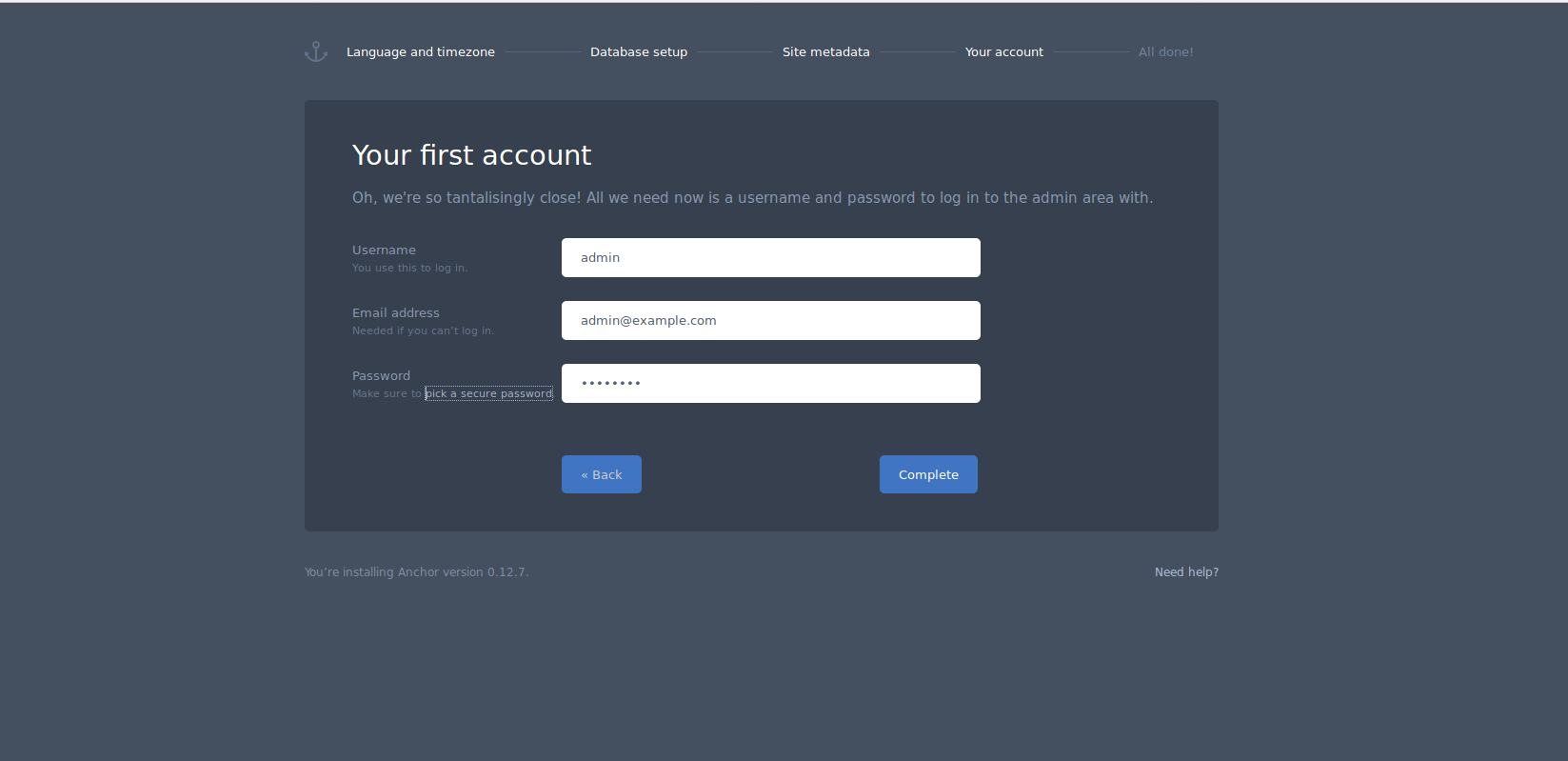

Provide your admin username, password and email, then click on the Complete button. You should see the following page:
Now, click on the visit your admin panel button. You should see the following page:

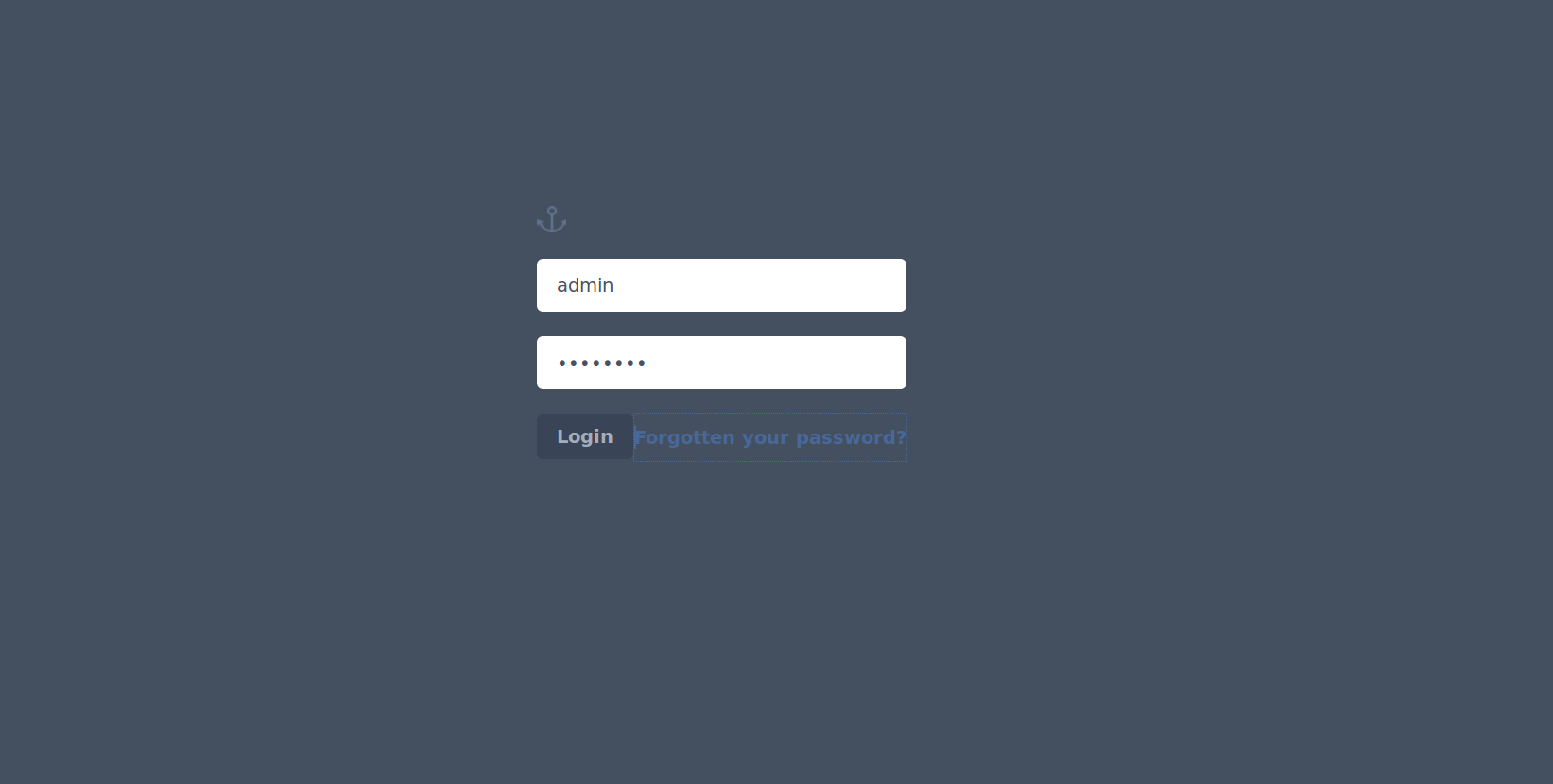

Now, provide your admin username and password, then click on the Login button. You should see the following page:
