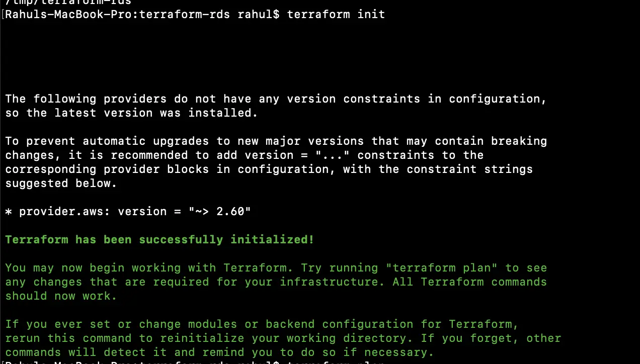

The first command to be used is ‘terraform init’. This command downloads and installs plugins for providers used within the configuration. In our case it is AWS.
 terraform init
Terraform init
