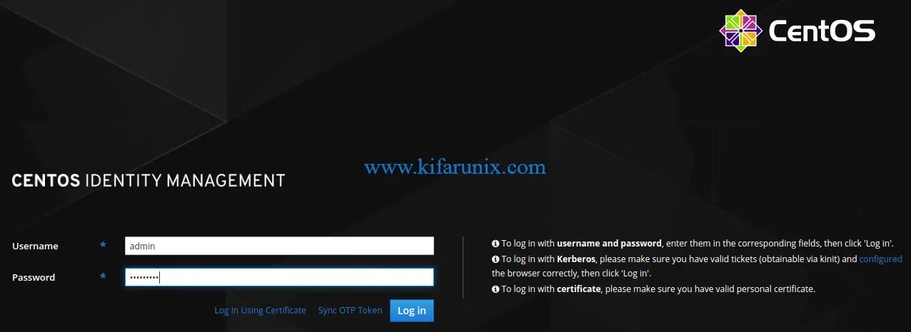

The FreeIPA server is now installed and setup on CentOS 8. Other configuration settings can be done from the web interface. On the browser, you can access FreeIPA using the address https://freeipa.kifarunix-demo.com.
Ignore the private SSL warning and proceed to FreeIPA server login page. Use the username, admin and the admin password provided during the installation setup.

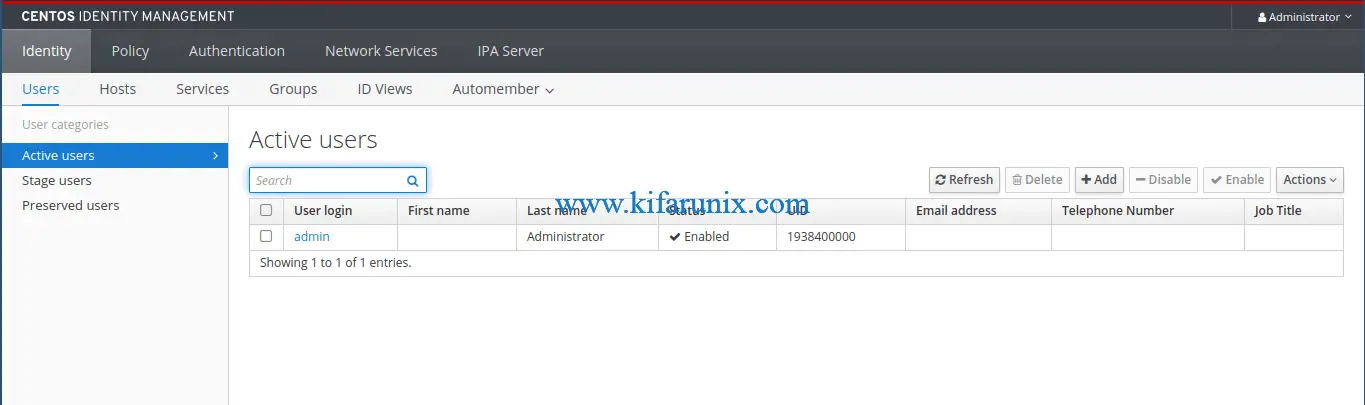

The default CentOS 8 FreeIPA server dashboard looks like;
You can now perform the FreeIPA administrative tasks from the web interface.
