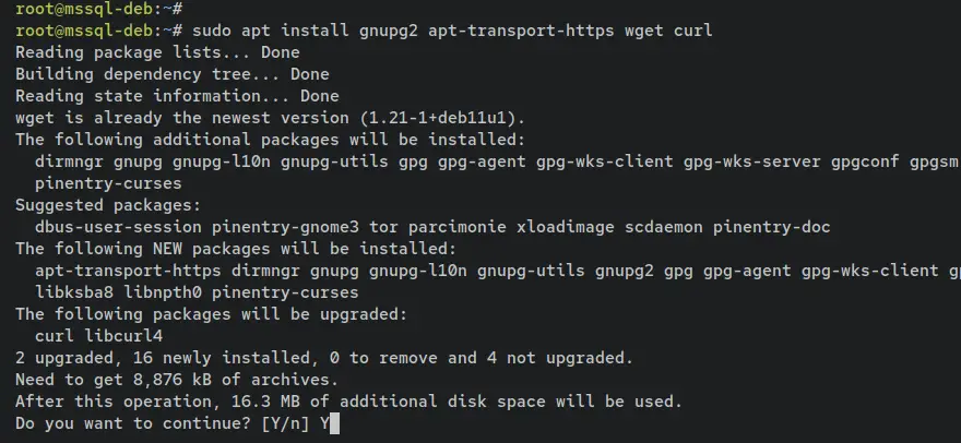

Now install some basic dependencies using the following ‘apt install‘ command. Input y when prompted and press ENTER to proceed.
sudo apt install gnupg2 apt-transport-https wget curl
